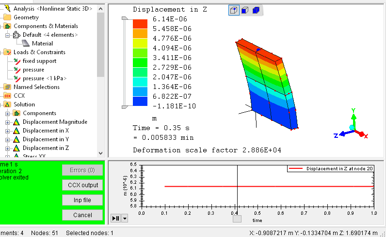

  • Here's a plate with two opposing pressure loads. One is constant and the other increases with time. Deflection should start at a maximum then decrease to zero as the opposing pressures balance. Due to the bug, the deflection is constant and nonzero through all time.

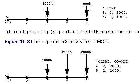

    Is not a bug is the same principle applied by ABAQUS.
    This happens also creating 2 or more steps. Same load applied to the same entity is replaced with the new load, also selecting OP=MOD (As a default)
    Attached picture explain the principle
    So if you want to apply a load composed by a steady component and a variable one you must define only one amplitude card. I think that's reasonable
  • Here the solution inverting loads sequence and the right solution
  • Yea, it's part of the design of CCX too so I call it a bug in Mecway, not in CCX.
    I think the pressure on Correct.liml should be from -1 to 0 instead of 1 to 2 because the constant pressure is in the opposite direction to the variable one. I changed it in Correct2.liml attached here.
    In version 8, both Inverted.liml and Correct2.liml will produce identical solutions because it'll use *DSLOAD instead of *DLOAD. *DSLOAD allows a different amplitude on each face of a shell element whereas *DLOAD only has a single "P" face.
