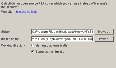

  • has the MT-version of SPOOLES  been compiled?
    I've 1cpu for spooles again, and I wrote all possible enviroment variables
  • There is no MT-version on the final release. I have recovered from the beta 3 and selected in the Options/Calculix window. Maybe there are some mistakes present so the author has decided not to include.
    By the way, why exist an option to select an CCX input file editor as well? I don't remember if there is an option to edit using an exernal editor.
  • Yea, I removed the MT version because of the buckling error that Andrea found.
    The .inp file editor is for viewing the generated file when you press the ".inp file" button on the solver panel. It won't automatically use any edits you make but you could save and solve it separately though.
  • edited April 2017
    I use Scite as a editor. This editor prepared by J. Baylor has the integration with CCX and CGX. So you can launch the pre-solver-post directly from the text editor

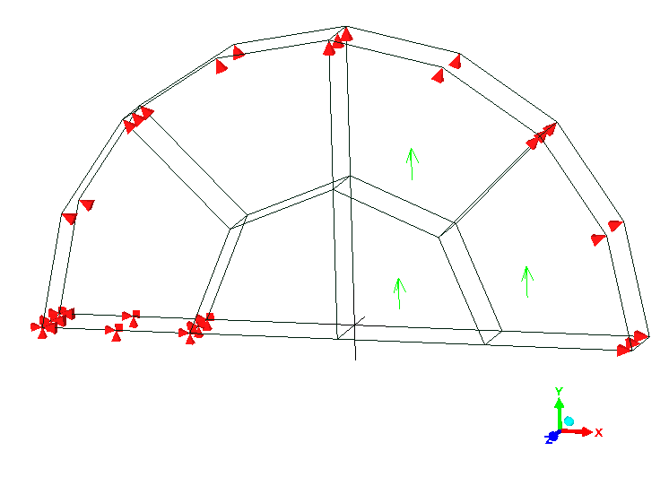

  • Hi. I have been too spoiled by using high end systems for to long.
    How do i proceed to convert displacement constraints to a function of position to allow cylindrical and other coordinate systems. This would be very helpful to have a tutorial on.
    Also is it possible to use the same functionality to define element local coordinate systems in order to define anisotropic materials to materials?
  • You can enter a formula in each of the boxes for the direction of the displacement. For example, the X, Y, Z components being x, y, 0 respectively defines a radial displacement direction as in the attachment.
    It's not yet possible to use formulas for the element coordinate systems but I hope to add this soon.
