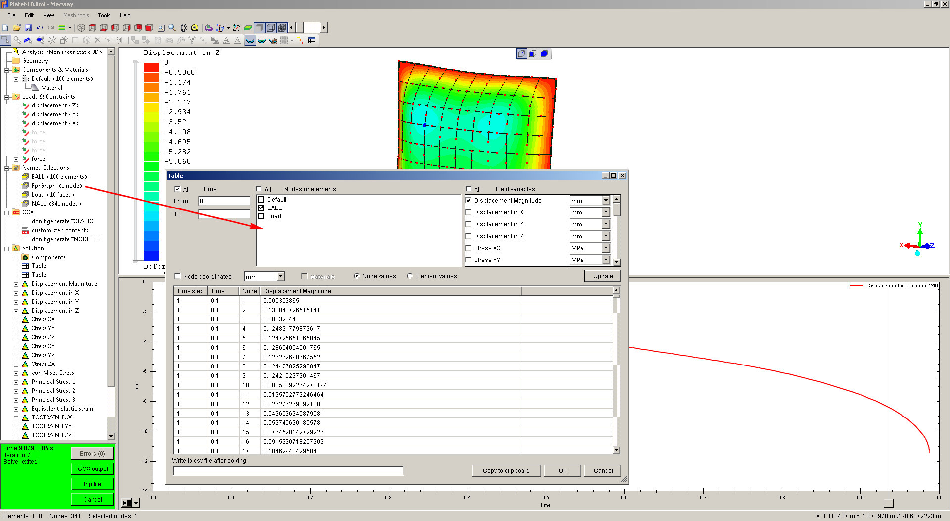

I'm trying to obtain a nodal displacement Vs time (for only one node) from table command.
I tried to add the node to a new group but doesn't compare in the table, so I have always all the node displacements. Obviously saving as CSV or copying to clipboard is possible to elaborate the table into a spreadsheet. But does is possible to have only the displacements of the selected node?
NLB.jpg 380.1K
  • Node selections are currently not carried through with the CCX solver. That's because it's more complicated than elements and faces when CCX generates extra nodes on shells and beams.
    The closest way would be to use a face or element instead, but you'll still get all of its nodes instead of just one.
