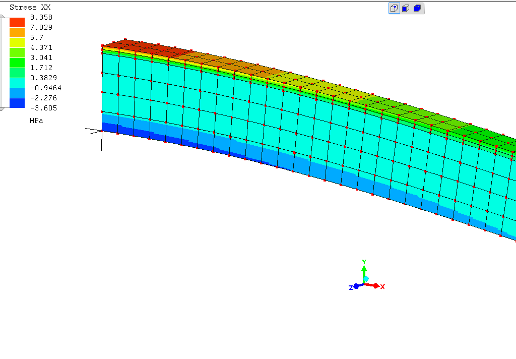

  • This one works. Changes I made were:
    • Added a *SOLID SECTION block to link the *MATERIAL to an element set.
    • Added a layer of ordinary linear material on the top so it doesn't fall apart when it goes into tension. This represents reinforcement.
    • Reduced the force.
  • Here's the .liml file I didn't attach.

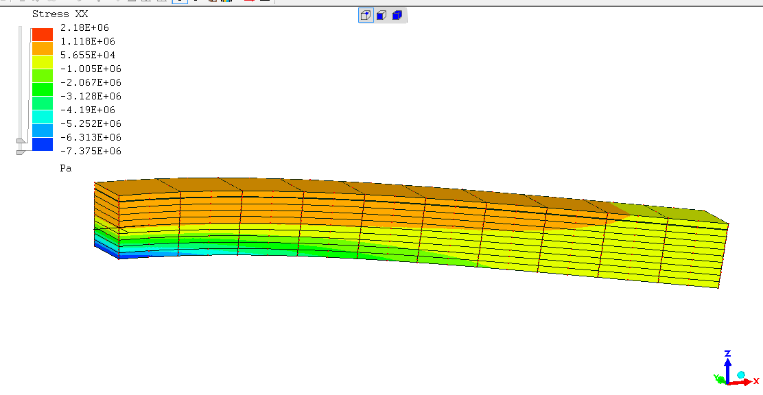

  • Victor, thanks a lot for your reply. That worked.
    I'm trying to model an experimental 4 point bending test in a reinforced concrete beam.
    The modeled steel was meshed with an equivalent area layered inside the concrete.

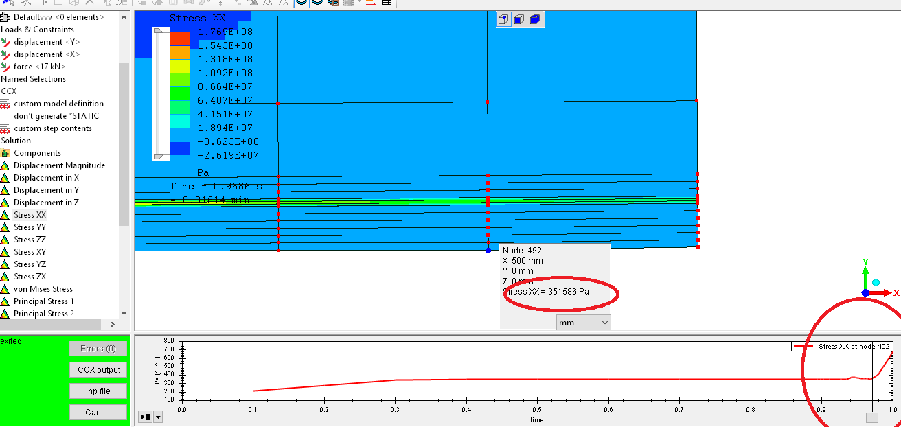

    I started by applying load in 5 kN increments (from each analisys I plotted the load-displacement values at the center of the beam), but  I started to having some convergence problems for applied loads higher than 15kN. Beyond this load large deformations appear in the support area.
    So I've edited custom step contents and applyed loads with 1 kN increment above 15 kN. This way it converges but there are still large displacements in the support area (see the liml file). Is this supposed to happen? I've attached the liml file and the plotted chart.
    Also, I'would like to try apllying vertical displacements instead of loads. How can I model this: apply a displacement increment of 1 mm until the maximum stresses exceed the ultimate tensile strenght of concrete (3.5 MPa)?
    Thanks.
  • It's probably because the material near the supports has broken. The graph shows it's tensile stress suddenly exceeding the limit so it probably loses strength in all directions when that happens.

    Thanks Victor. Should this happen even if the tensile stress (0,35 MPa) is lower than the strenght (3.5 MPa)?

  • The tensile strength is only 0.35 MPa according to the material definition so it seems to be failing just right. Maybe that's a typo?

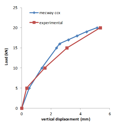

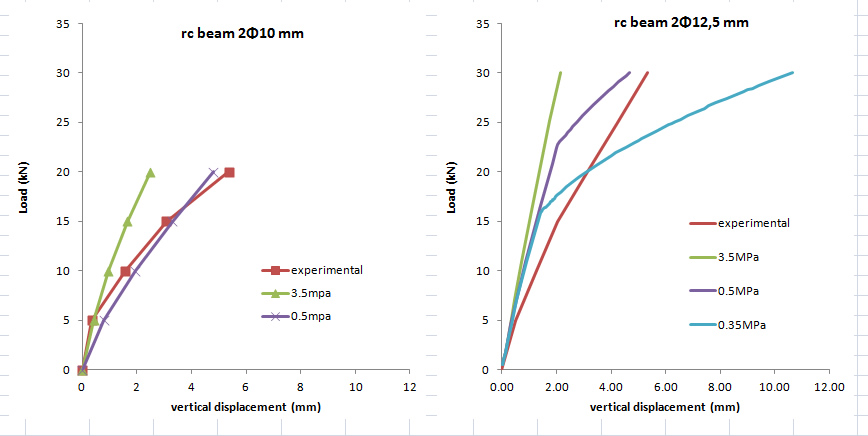

    So I've modeled 2 rc beams in a four bending test: One is under reinforced (10 mm rebars). I've attached the ploted values (experimental and mecway non linear with concrete as a compression_only material).
    Steel was modeled as bilinear isotropic hardening. I've tried with 4 different tensile strenghts for concrete: 3.5 MPa (10% of compression strenght) and lower values.
    The FEM results don't seem good unless I choose a tensile strenght for concrete of 0.5 MPa (the ususal value is about 10% of compressive strenght).
    For better results with 4 point bending testing I believe I would need to use a user_material subroutine for concrete based on abaqus plasticity damaged model including the stress strain curves (compression and tension softening). I've read calculix manual and it's possible but it seems complicated for a beginner like me to do that. Can someone help me on this?
