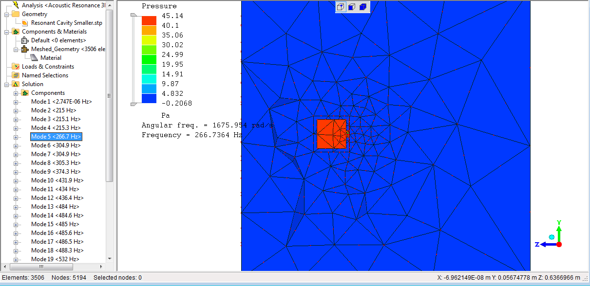

I created a cavity 3D model in ViaCad. The model is essentially a larger cube, representing room air, enclosing a smaller cube, representing the actual cavity. STEP file was exported, as attached, for Mecway. Acoustic resonance 3D analysis with 30 modes was employed. The STEP was imported in Mecway. Default setting was used to generate mesh.
I checked all the modes and found Mode 5 (266.7 Hz) resulting highest pressure in the cavity and low room pressure. This should be the resonant frequency of the model. Am I correct?
Both STEP and Mecway files are attached.
  • Yes, I'd say so. I also found that changing the size of the room changes the frequencies of the other modes but not the 266.7 Hz one, further indicating that it's independent of the room's geometry, as you'd expect for a cavity mode.
    It's also a good idea to refine the mesh and solve again to make sure the mesh is fine enough. In this case it's already pretty good.

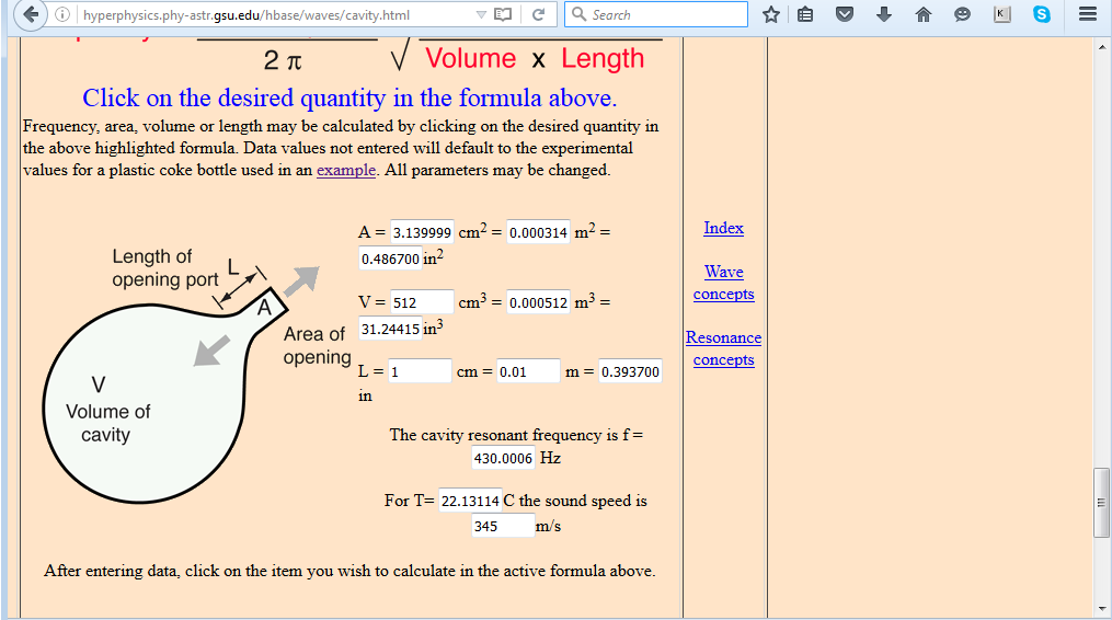

  • Thanks for your comment. I used an online cavity resonance calculator (http://hyperphysics.phy-astr.gsu.edu/hbase/waves/cavity.html) to verify the result. The cavity volume in the model is 512 cm3. It is equivalent to have a circular port of length 1 cm. Port area is 3.14 cm2. I put these numbers plus 345 m/c for sound speed to the calculator and got 430 Hz, as shown in the graph. Do you see anywhere I did incorrectly?
  • Thank you tcarson! I tried the link of mh-audio and got the same result. Now my question is solved.
  • Hand calculation and the online calculator are approximation. Correct understanding?
  • Sorry in advance for the long post
    It looks like most websites don't take into account the effective length for the port. not always an issue but with the choices you made for the port dimensions it is.
    the effective length is equal to the port length plus 1.6x port radius. this is for sudden expansion opening. flared ports would be different. I would not say that hand calcs are approximations, but rather are a model for a very specific case.
