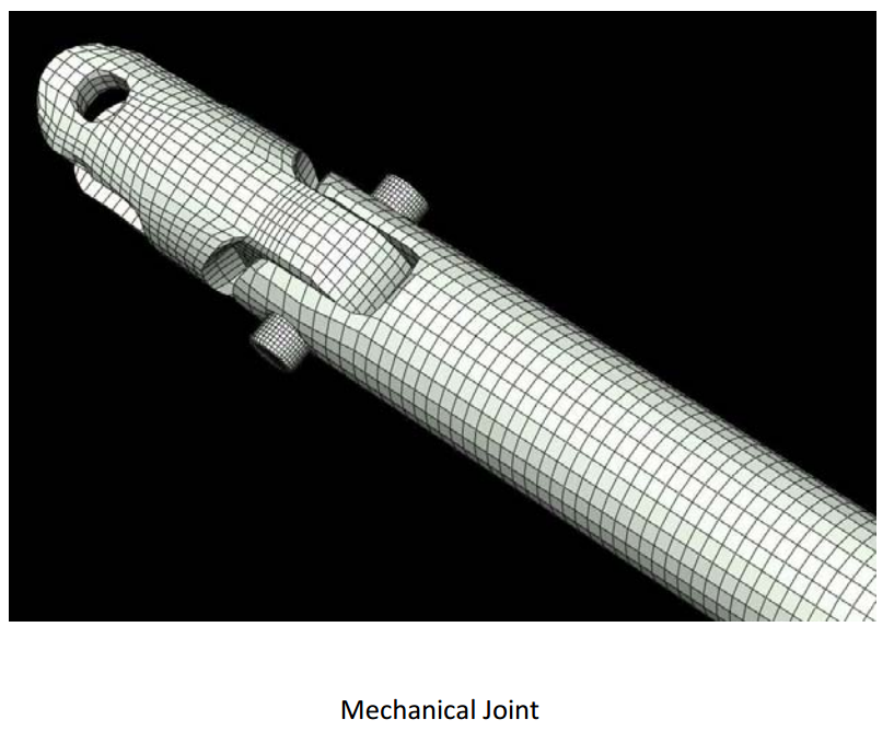

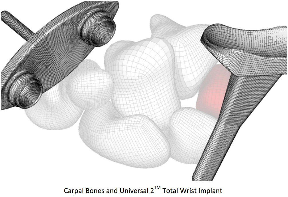

  • IA-FEMesh seems to be able to hex mesh mechanical parts. Sergio, have you tried? What file export does IA-FEMesh offer? Can we import the mesh into Mecway for FEA?
    (Images attached from IA-FEMesh manual)

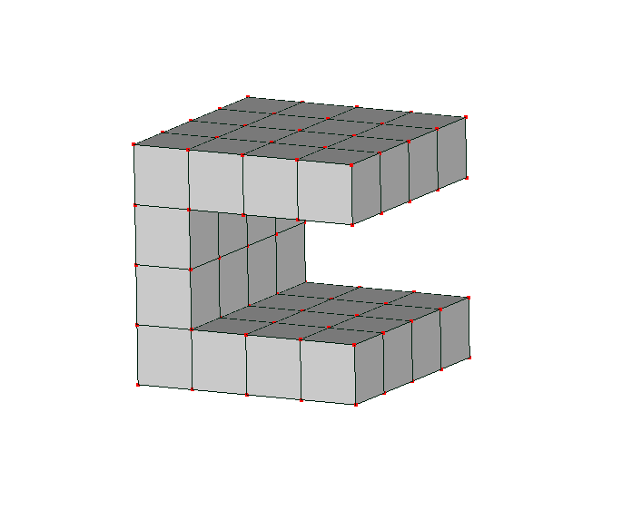

  • That's an interesting idea for a feature "mesh selected surfaces". For now you can still do it by meshing all the surfaces then deleting the ones you don't want. To aid in deleting them, you can make a named selection of the faces to keep, then switch to Select elements mode, invert the selection and delete what's now selected (all the unwanted surfaces' elements).

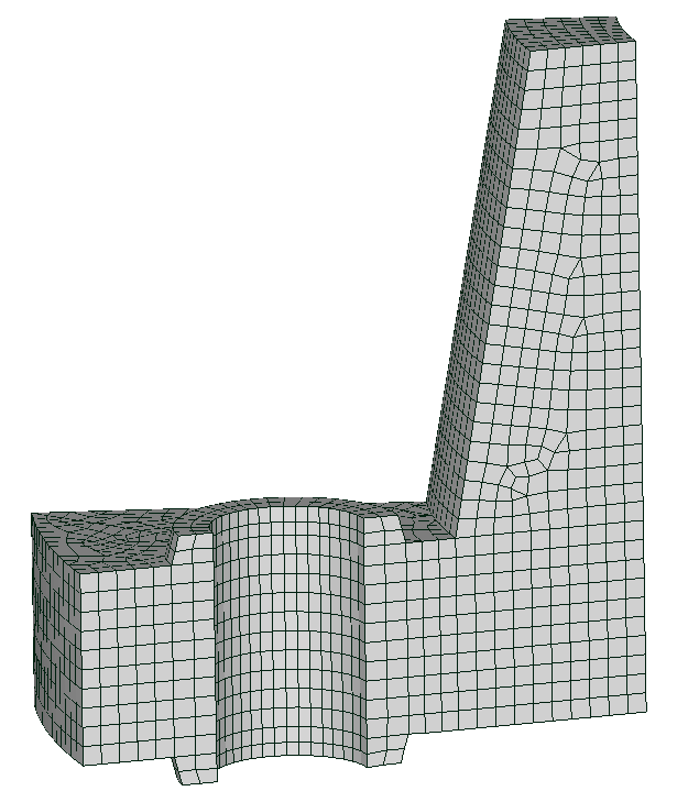

  • edited February 2016

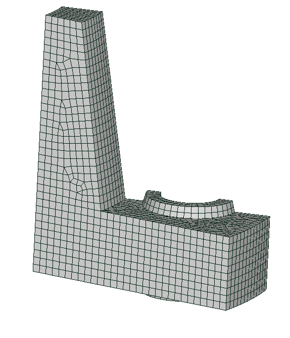

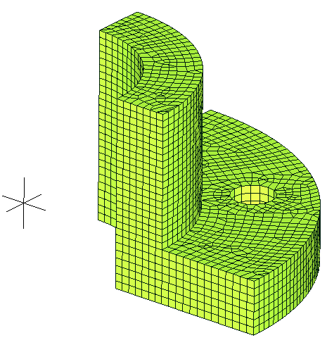

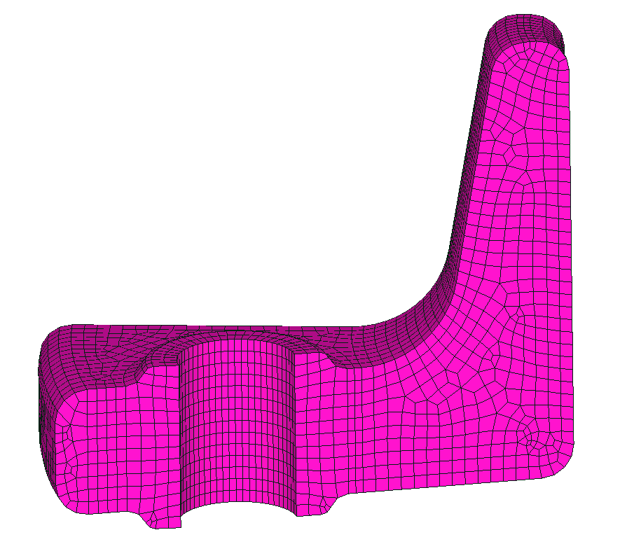

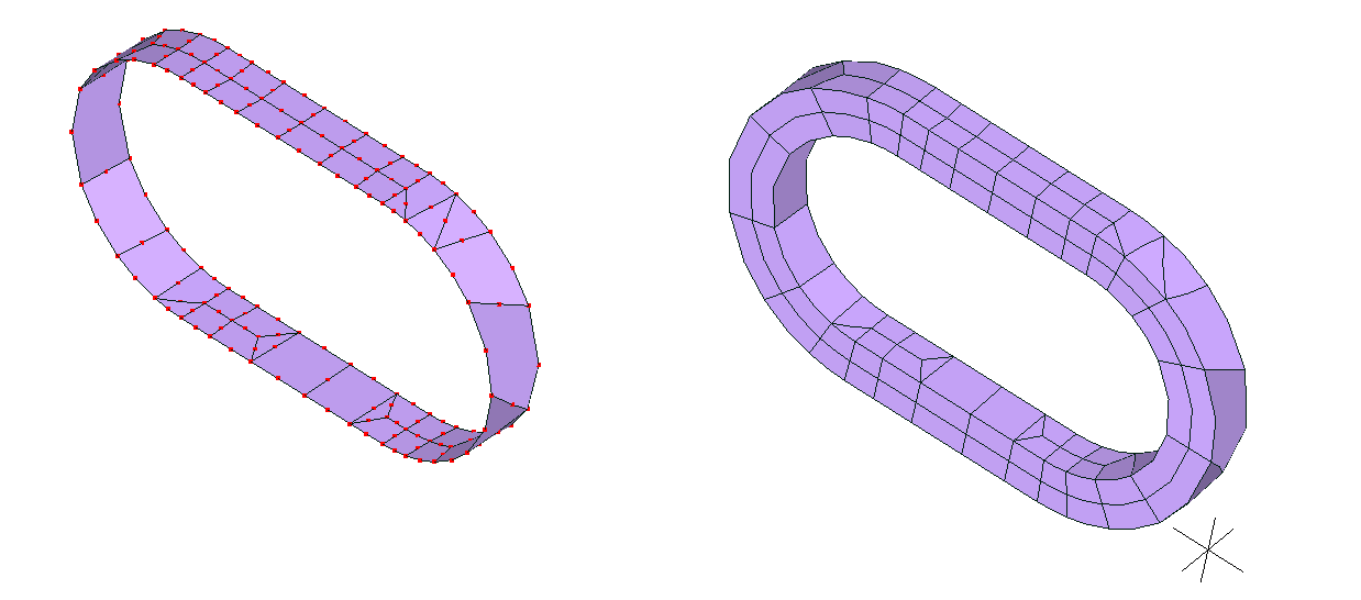

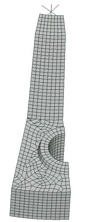

    I have tried some simple parts, and for very simpe could work (see . I have added a little of complexity and then arise some troubles:
    1) We need a wireframe view and possibility of select hiden surfaces to then invert selection and delete elements. Guess that the best will be every surface identified and their mesh also identified separately. As was really dificult (or impossible) to select the hiden surfaces, I has solved exporting in the CAD only the surfaces that I need to mesh (this adds an extra step of planning the mesh secuence)
    2) For the bosses of the second part I try by revolute the elements, we need a possibility of select the position of the revolution axis (now is only possible in the global coordinate system axis, but for features not in the center the rotation can't be done.
    3) I have tried to swep in place of rotate, it works when I use 2D element edges as guide/paths, but not when the guides are 3D element edges (I have solved creating a set of 1D elements over the edge of the 3D elements.... now how I could delete it?) Even that the sweep don't conect the nodes that are not in the path or guide, and the faces of the last element loose the normal direction, so I make a lot of manual node reposition to merge with the existent elements.
    4) Still I didn't find a way to make a symetric copy of the mesh as the symetry plane is not an ortoghonal one. I have tried the point option but it makes a rotated copy, not simmetric
    This is my first tries with hexa meshes in mecway, surely the practice would improve. Guess that having the option of just mesh by selected surfaces would improve a lot, and if can be with only quads even better.
    Having hexa mesher capacity will be a great plus for Mecway, even more now that people will start to use as prepro for CCX.
    The first simple is the yellow, the second (not in the pics or model) was a try to make the next part with bosses and draft importing the solid (but I was not able to select the hiden faces), the third (grey) is then the same model but just only importing the faces needed to mesh
    Tomorrow I will try some parts with radius to see if it can be done.

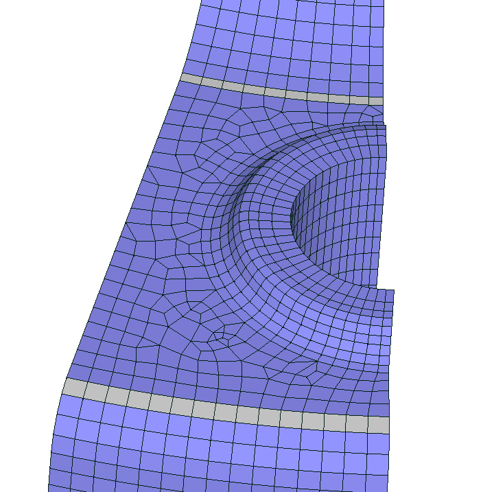

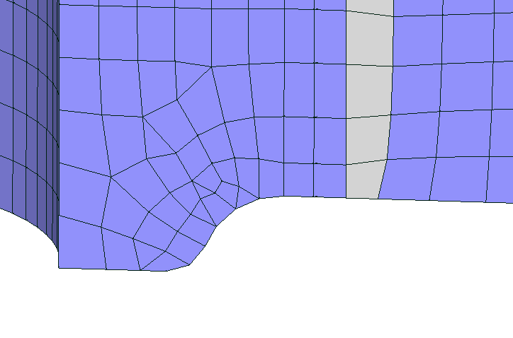

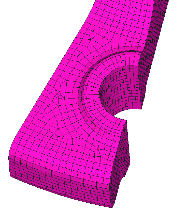

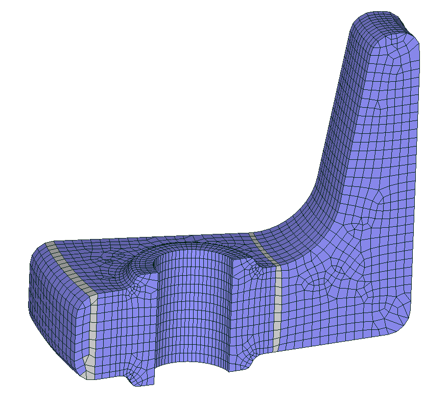

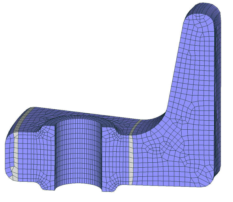

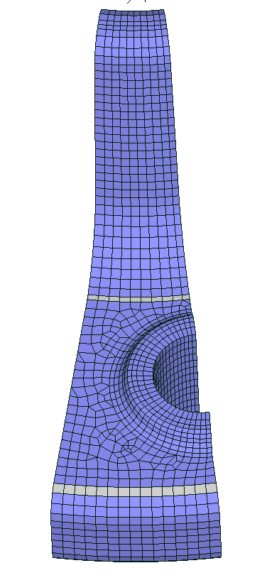

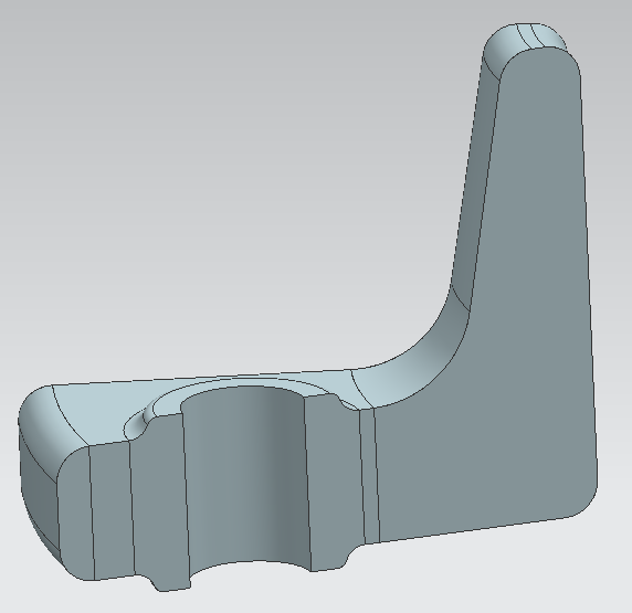

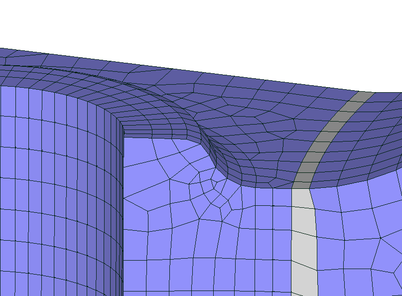

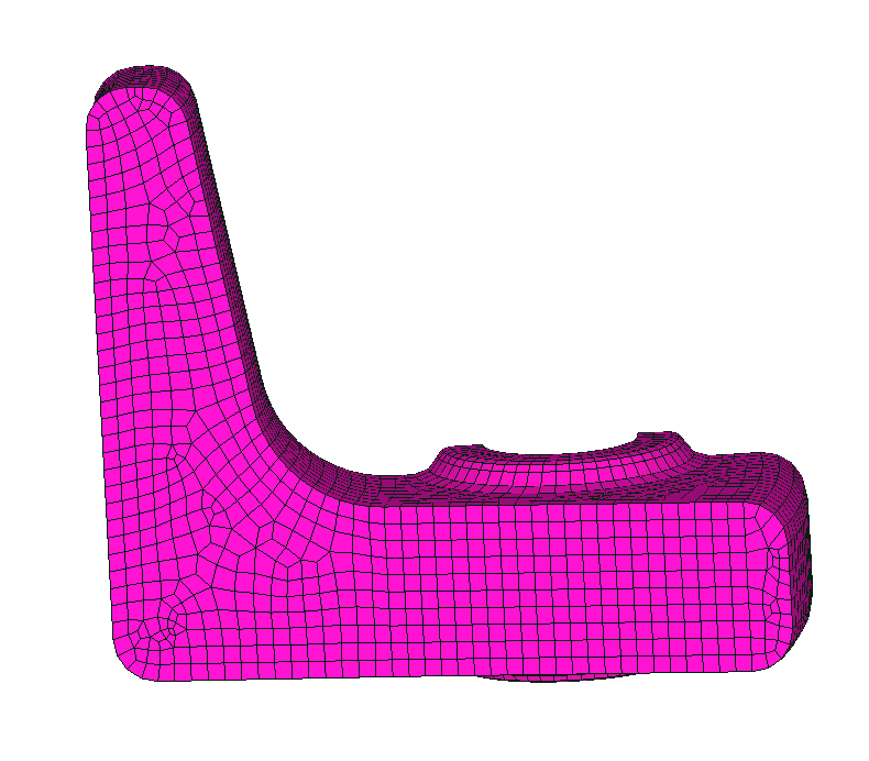

  • Hi, following with my tests of the extructured meshing in Mecway, I took the last example and add some radius to the bosses and the tube, places were normally stress will be concentrated and need to have a good mesh. I didn't put attention on mesh quality, just is a test to see if is possible to mesh in a extructured way.
    Happily I was able to mesh all the part, and found very usefull the sweep command (more than extrude or revolve) as it permit to keep the element spacing along the path. Extrude or revolve will make perfectly evenly separate elements, but sweep use the path as reference for spacing, and this important to match with the nexted meshed volumes.
    Again, will be a great help to have the possibility of using 3d element edges as path/guide and not have to add extra 2d elements. The best would be some kind of "autoselect" for the element edges by tangency or conectivity to avoid selecting one by one.
    Another improvement would be that when the 2D meshes were created, is the possiblity of have every surface mesh grouped automaticly (is just create a named selection for every surface), so then sweep/extrude/revolve operations become more easy
    The grey elements are those that I was forced to delete and recreate (on 2D meshing before sweeping) to keep the node conectivity. First I tried to move the nodes manually, but is quicker, easier and precise (to don't lose the plane) to delete and recreate manualy.
    I'm really impressionated by the things that can be done with Mecway!

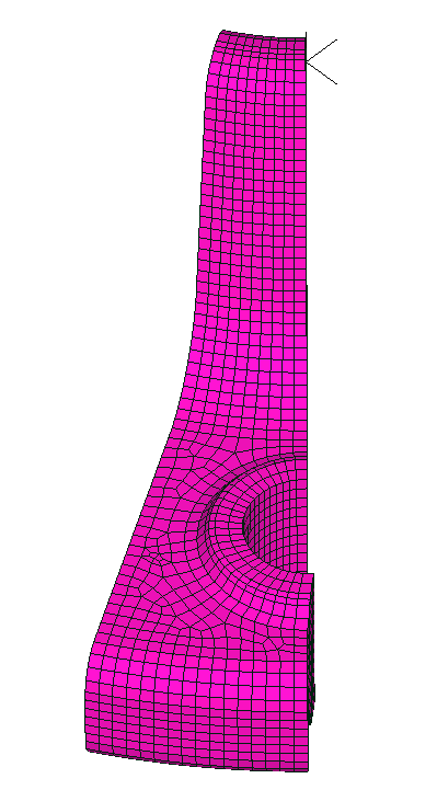

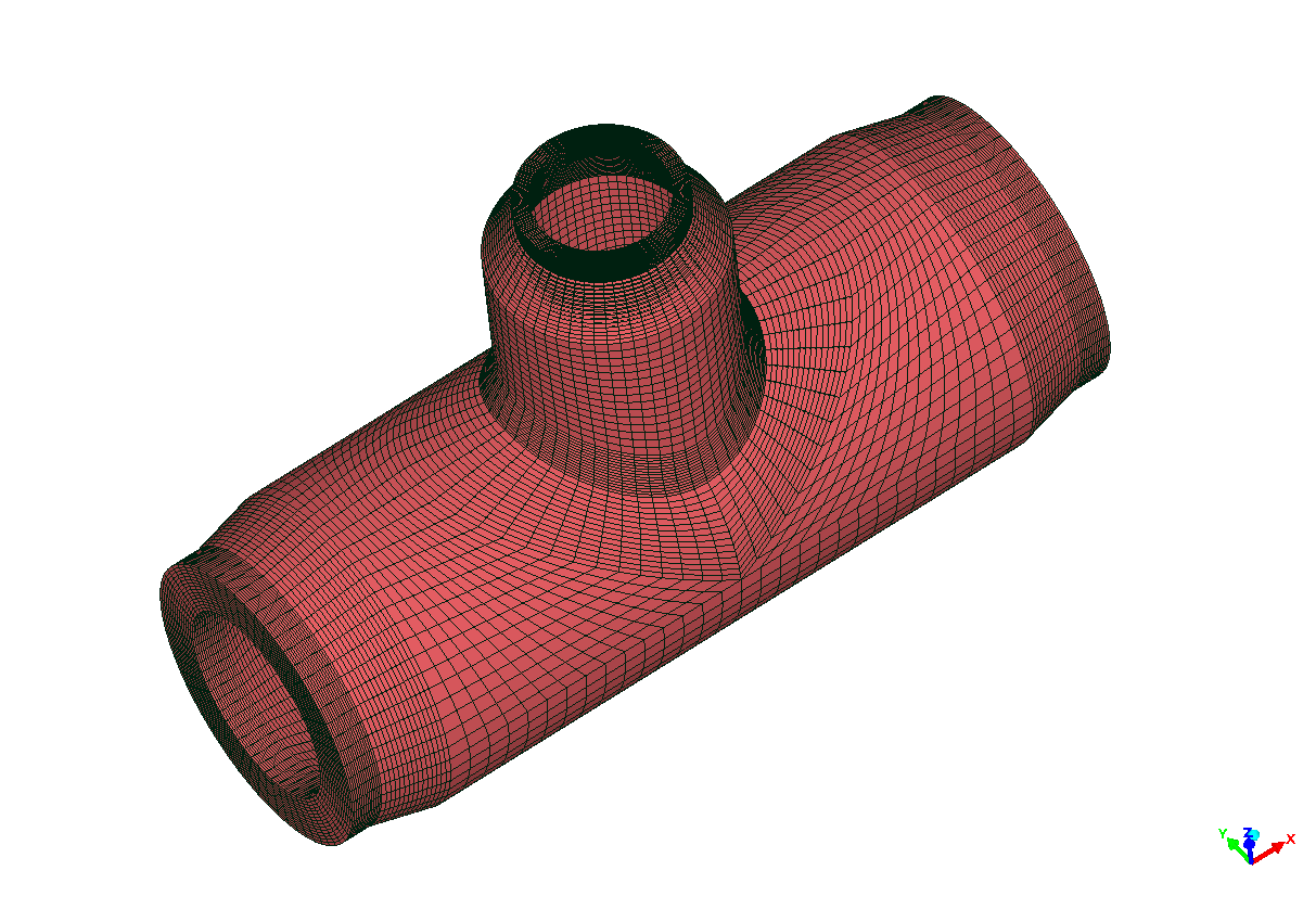

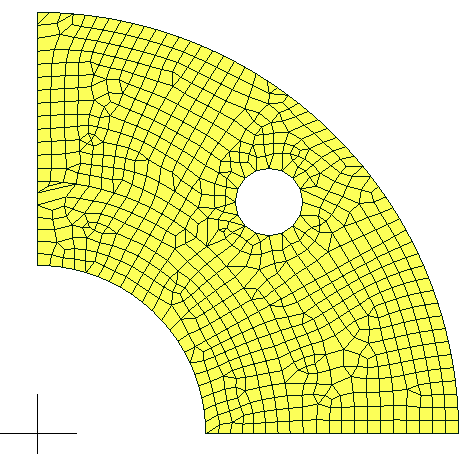

  • Until we convince (hey, we need more people, please make noise in this thread!) Victor to add fully 2D quad mesh in Mecway, in order to have a full hexa mesh the parts (faces in fact) can be meshed (2d seed quad meshes) in Roshaz and then export to Mecway to do all the sweeps and extrusions. I will make this same part in this way to see the difference.
  • This is the same parte now with quad mesh in Roshaz and then sweeped in Mecway...the procedure was really straighfull, and now is full hexa.
    Guess that the next step will be meshing in IA-FEMMesh also.

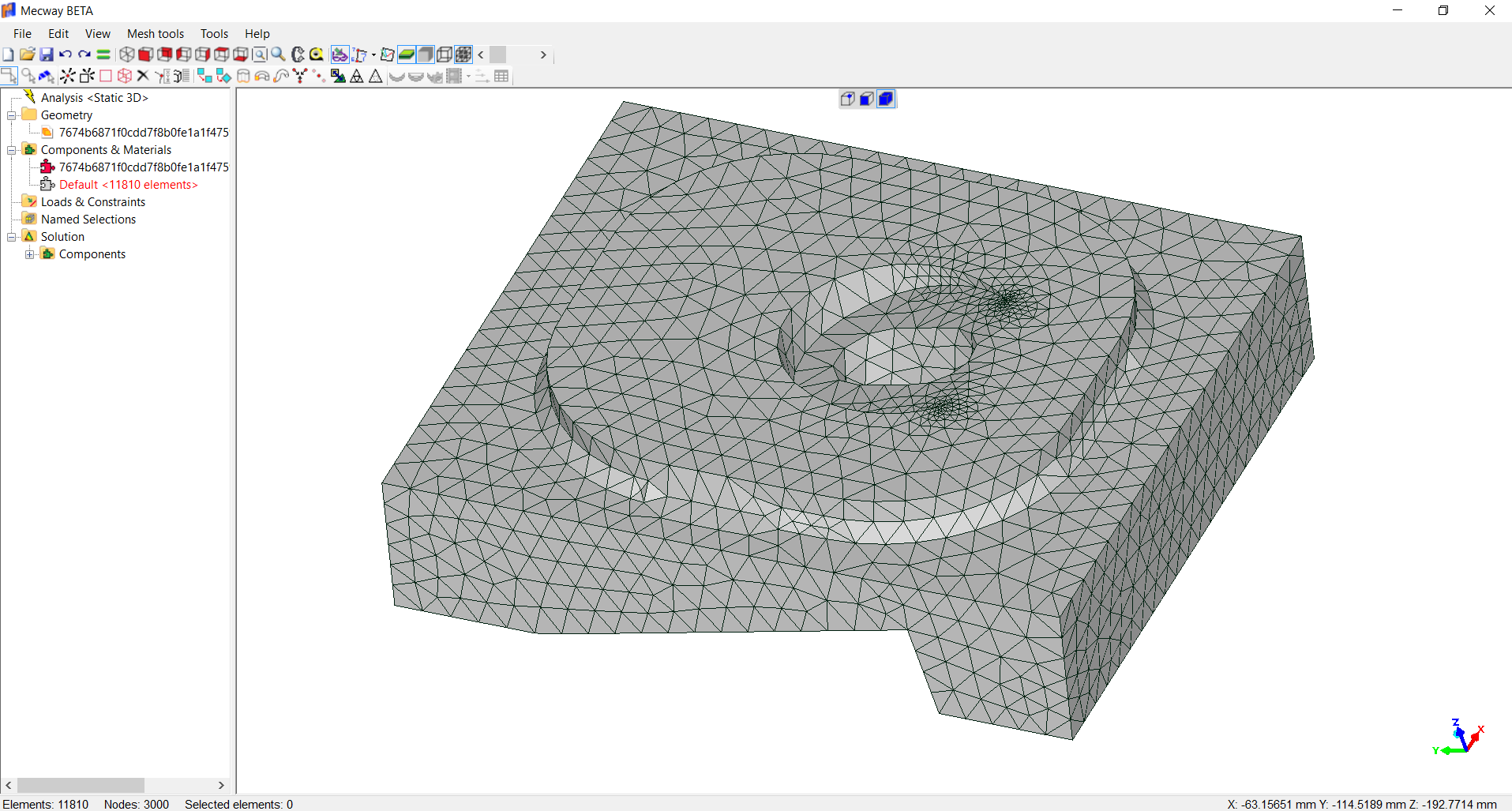

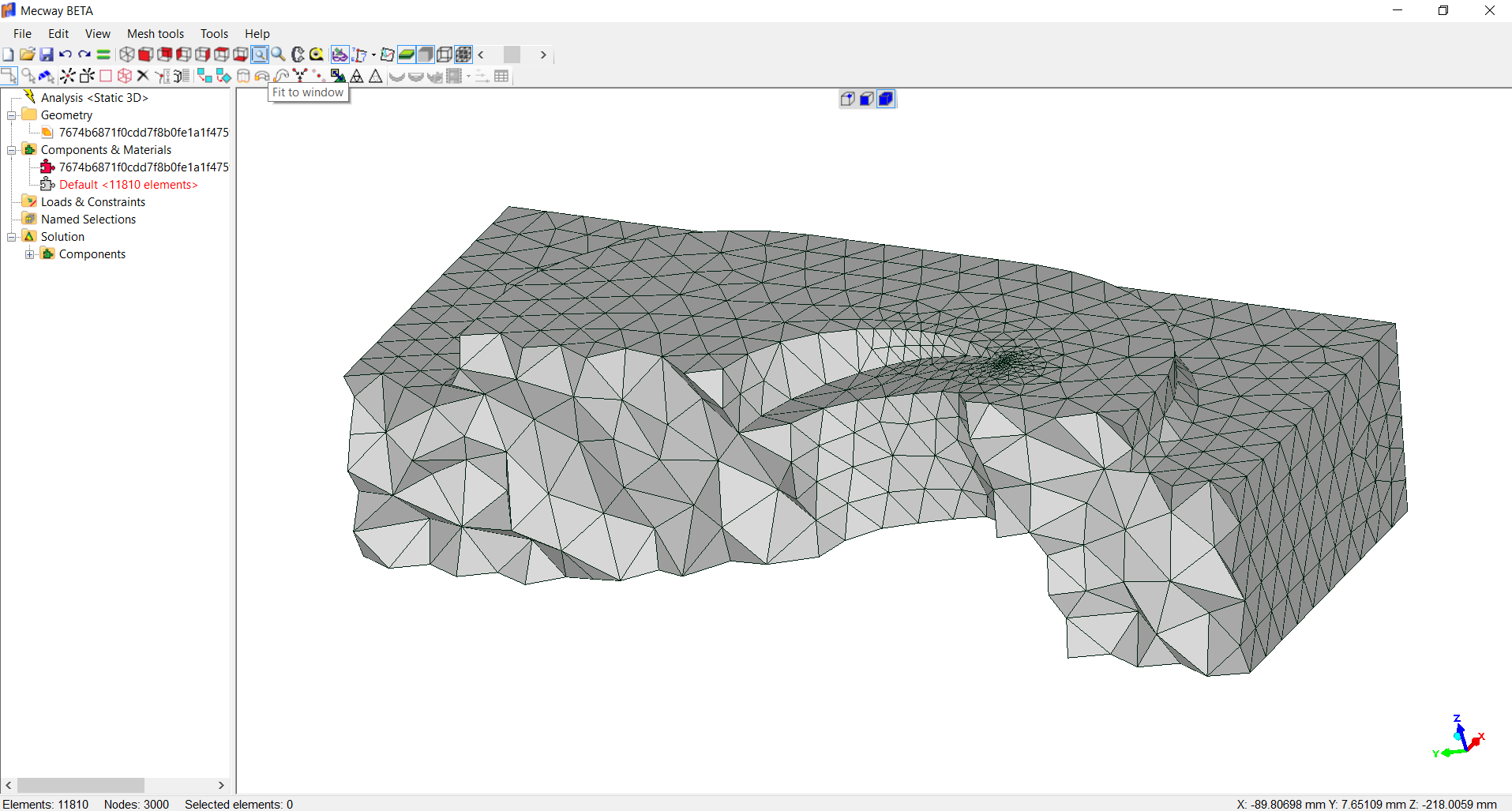

  • edited April 2016

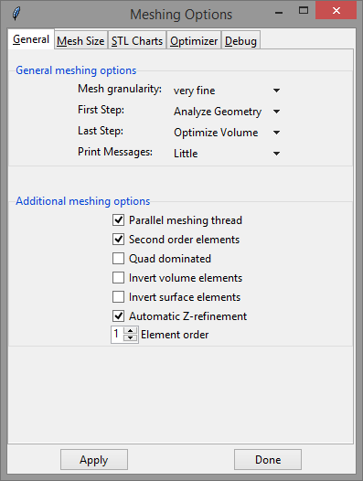

    I was testing out Netgen 6.1 Experimental and was surprised to see it can now auto generate 3d hex dominate meshes.
  • That's amazing news!
  • Darn, bringing the mesh into Mecway, I see it is still only a surface mesh.
  • What tripped me up is you also have to change another mesh option. The last step needs to be changed to Optimize Volume. I attached a picture of the settings.

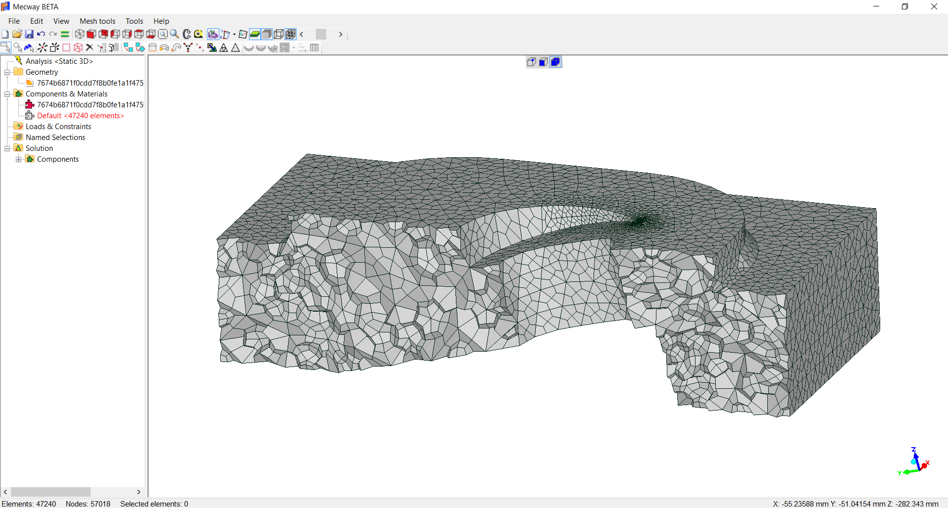

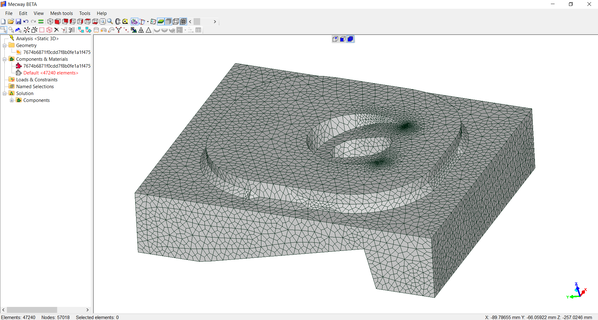

    Just to give another option to hexameshing, I have found in this new release 6 (not sure if is a new feature), an option to convert tet4 elements into four hexa8 elements, that is, a mesh of tetras to full hexas. They are not so perfectly shaped as if they were extruded or revoluted quads, but they will give very razonable results for the cost (time to mesh it). The tool is under Mesh Tools/Change Element Shape
    This is the example part uploaded by UGMENTALCASE, first meshed with tet4 and after converted to hexa8 with Mecway.
    I have several comparations using tets vs regular hexas and this "converted hexas", and they perform much better than tets in terms of stiffness and stress for big displacement analysis.
  • edited October 2016
    I tested this approach some time ago as a customer followed the rule to accept hexaedral meshes only. Make sure the tets are in in good shape.
