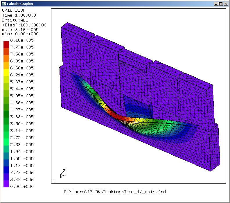

    I ran the solver and Mecway opens the frd file but is very slow.
    With CGX the solution on the attached picture

  • Hey @Andrea. I opened it in mecway. thanks to you . There are three components in my geometry, I want to extract the value of stress thats enclosed inside the two other geometry but I cant get a sectional view or an option to remove other solids so that I can extract the result. @Victor can you shed some thoughts into it too
  • The cutting plane slider on the right of the toolbar hides foreground elements. That's OK if your surface is flat but would need several adjustments to see all over a curved surface.
    If you use Mecway as the preprocessor then it carries components through to the solution so you can hide them individually.
  • You can hide/unhide components of the assembly in CGX directly, you must open the .frd and .inp files from the command line. Check the CGX documentation or look in the CCX Yahoo list, I remember that this question was answered there.
