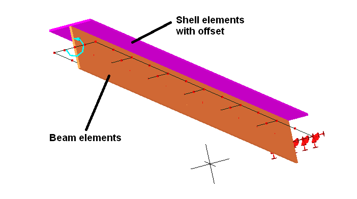

  • Thanks VMH, that's very clear. I would add that you can also move the stiffeners away from the plate a little to make a more realistic connection without the flanges being embedded in the plate. Bonded contact allows some gaps like this and the structure's stiffness will increase accordingly.
    An alternative approach, if all the stiffeners have the same cross-section, is to use beam elements for the stiffeners and shell offset for the plate. The CompositeBeam.liml sample included with Mecway shows this.
