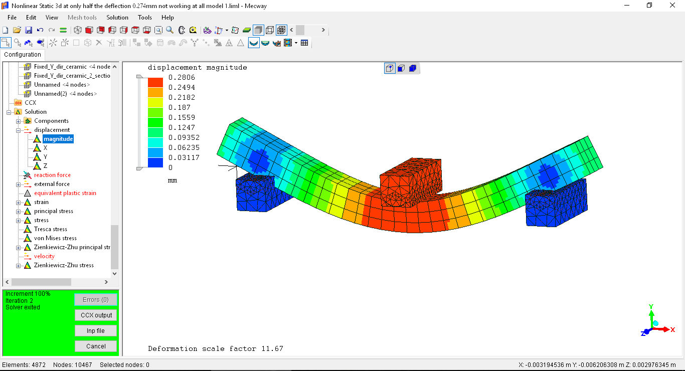

  • The main problem is that the two SSteel materials have Youngs modulus = 200 Pa. I changed them to 200 GPa and it converges.
    I also turned off quasi-static since there aren't any time dependent loads to make use of it.
