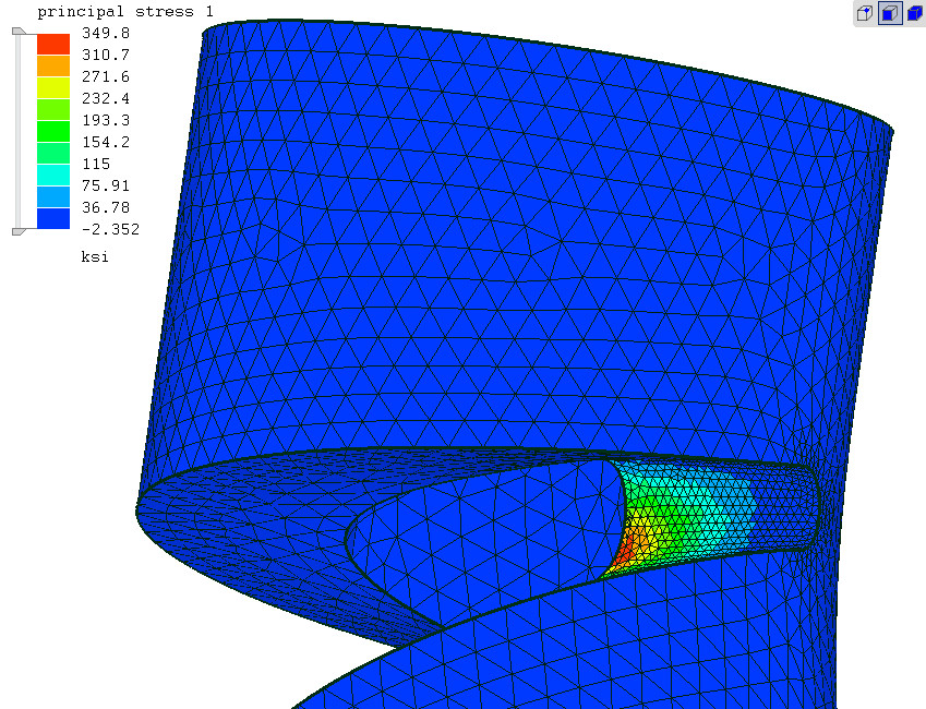

    the peek is 572000psi with possions of .391 after 20 or so iteration it did converge. Nonlinear the Von mises stress showed 280,000 psi at a stress riser that will have to be dealt with. at an inside edge of the spring it showed 91,000 psi. this seems a little high but could be getting closer. This model has 392,000 elements

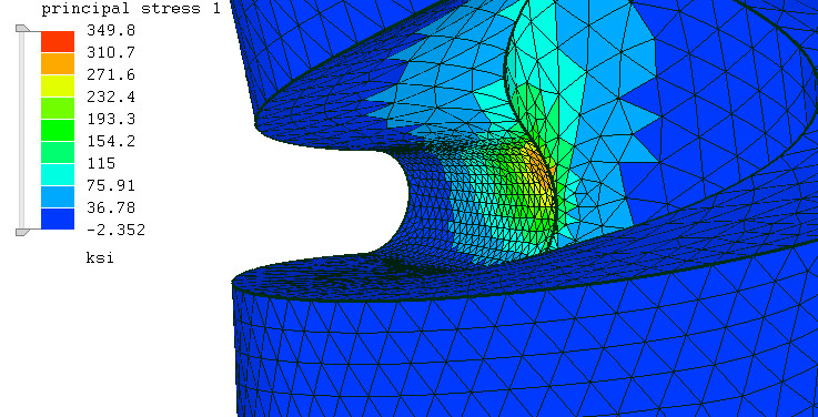

    I tried to apply 5lbf to the model and, without convergence study, I found a peak stress of 349.8 Ksi (first principal stress - NL analysis).
    The problem is to know the right conditions of work. Due to the geometry the spring loaded with a distribuited force bends. Is the bending possible during the normal conditions? If not is necessary to apply correct BC to the upper parts (where the force is applied). This aspect is confirmed visually plotting the deformed shape but also checking the peak stress which is different for upper an lower part.
    Generally forces are guided. I think that the actual model doesn't respect the real conditions.
    If I'm right is possible to refine the model applying the force by RBE locking the upper face rotations around the xy axes.
    Other aspect is the peak stress. Is located on a edge and so I think that reducing the mesh size the stress will growth. So, for my opinion, is necessary to create a fillet.

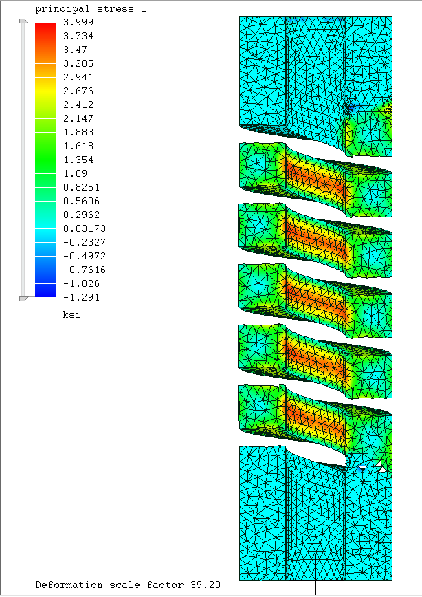

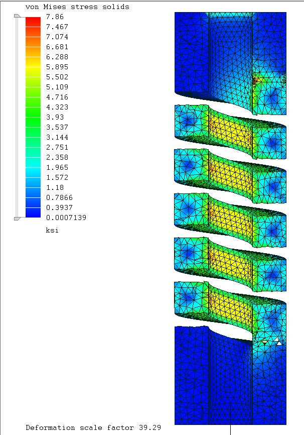

    Hello,

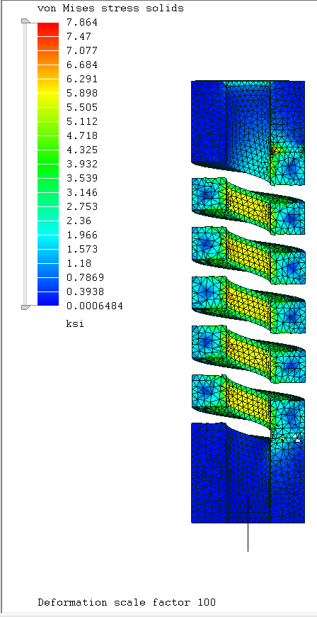

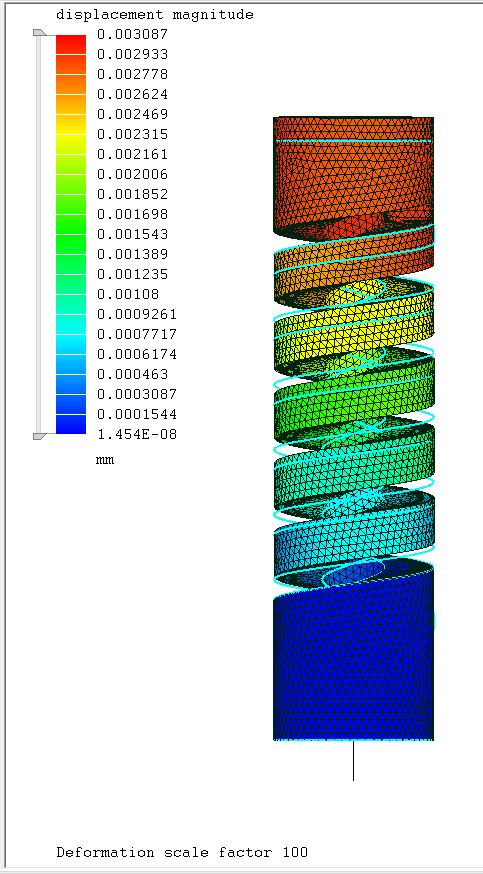

    I'm getting different values. Two orders of magnitude difference but in line with PEEK compressive strength of PEEK. I have applied the 5lb distributed in some of the upper nodes 5lb/24 each one of the 24 nodes. I have left the spring free to expand and rotate but vertically centred.
    Von Misses 7.86 Ksi = 54 MPa
    Compressive Strength of PEEK 18.8 ksi= 130 MPa.
    5Lbf seems an acceptable load.
    ¿Am I wrong.?

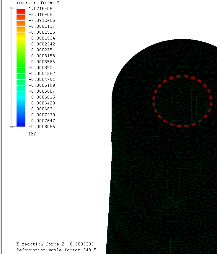

    Like twilliams55 I have been unable to recover resultant force on the base to check force equilibrium in the vertical component.

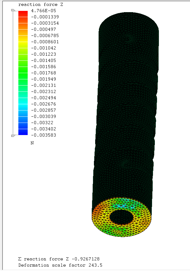

    Reaction forces
    To see the sum of reaction forces in the Z direction, click the Z component of reaction force in the outline tree. The numbers on the color scale are not really meaningful because they're individual node forces which depend on the mesh. The sum is shown at the bottom of the graphics area. That's only available directly if you're using the internal solver.

    Run again with new conditions ,ccx2.13MT, NL second order tet elements and obtained:
    -Von Misses 7.86 Ksi
    -Tensile Strength of PEEK is 14.9 ksi
    According to your results 90 Ksi , 5Lb load this spring is completely destroyed .
    Why so different values.
    Have a doubt why my sum of reaction forces is wrong.
    I have impose the load as nodal forces. 0.208 lbf/node on 24 nodes= 5 lbf TOTAL force.
    Victor, I run with internal solver and sum of z reaction force shows 0.208 lbf. Seems it is only considering I have introduce 0.208 lbf.
    I also found some coloured areas around the force application area. ¿ Why?
    Sorry being persistent but I take any opportunity in the forum to use it as exercise and learn.
