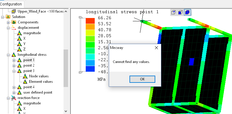

  • Hello Victor,
    an error occur when I use "find contour min/max" in MW8.
    Here attached a test model. When you try to find min/max contour of stress point 1,2,3 o 4 (for beam element) in a shell element MW8 crashes.
    I know that I could not extrat the contour min/max stress point for line elements in a shell element but the software should advise the user without crashing.
    After the messages (attached) the visualization is locked.
    Thanks,
    Marco

  • Stefanos: Yes. I'll contact you by email in a day or two.
    Marco: Thanks for the bug report. I'm not able to reproduce it so could you please give more specific steps and/or take a full screenshot showing model and any selections? When I do it, it says "Cannot find any values".
    I assume you mean Tools -> Find max/min? I also tried Fit contour plot max/min to selection and that doesn't crash for a shell element and beam stress.

  • Steps:
    1) Solve
    2) On the solution tree select "Long stress point 1 element values"
    3) Select "Select element" in the edit menu
    4) Right key on a shell element -- > Find contour plot max/min
    5) Crash and locked visualization
    Here attached the full screenshot. I work with WIN10 Pro 64bit. Maybe is a problem of the Operation System.
    Thanks,
    Marco

  • I forgot the full screenshot of the second message.
    This message was displayed after these steps:
    1) click on "ok" of the first error message
    2) click on "Components and Material"
    3) Displayed second message and red lines appear on the screen.
    Marco

  • Thanks Marco. I can reproduce it now. It only happens with the gradient contour plot option.
