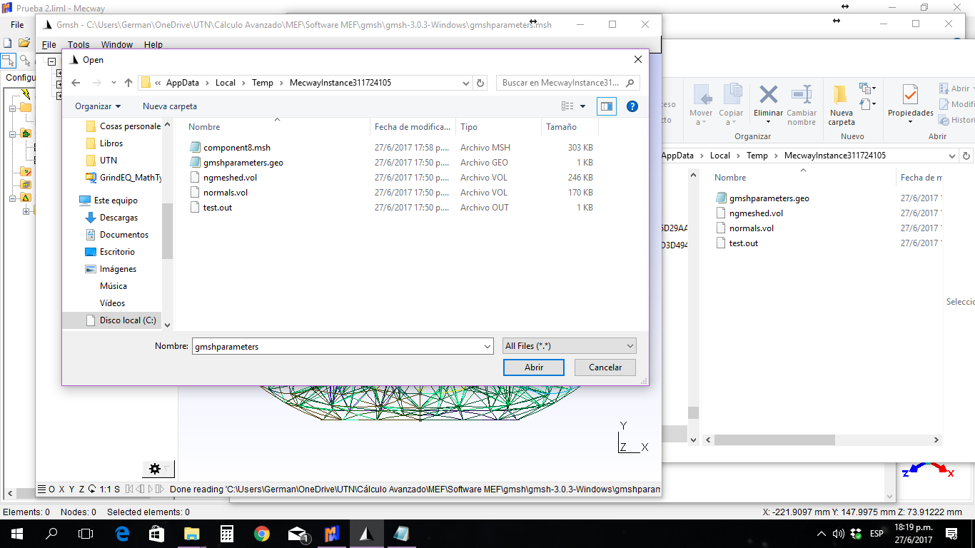

    Gmsh opens the geo file and saves the mesh, but windows can't see the file.
    I'm attaching the screen capture where you can see that component8.msh in the gmsh "open" dialog but not in the windows folder.
    In the "open" dialog I could edit the file with Notepad. If in Notepad I "save as" a different file, windows doesen't see it also.
    If I copy all the lines in the notepad, open an new Notepad file and paste into it, I can save as .msh and windows can see it.
    The same happens if I save other files with gmsh, windows can't see any file saved by gmsh.

    That's very weird. Perhaps in Windows explorer:
    Refresh the display with F5
    Turn on showing Hidden items.
    It also sounds like UAC virtualization where only the applications that created the files can see them. https://blogs.msdn.microsoft.com/oldnewthing/20150902-00/?p=91681
  • All hidden items are shown.
    This happens also if I run gmsh as administrator.
    The files are not in virtualstore.
    Running cmd and looking old fahion DOS DIR shows the sale files I can see in windows.
    It's like those files are gohst and only gmsh can see them.
    I tryed running in windows 8 compatibility mode also.

    Serigio, I've tryed running gmsh directly from different folders and the problem persists.
    Only gmsh can see the files it saves, not windows file explorer or other programs, neither DOS Dir command.
    Thank you both for your help.
  • I found the problem.
    Gmsh was running in Comodo antivirus Sandbox, in a virtualized folder.
