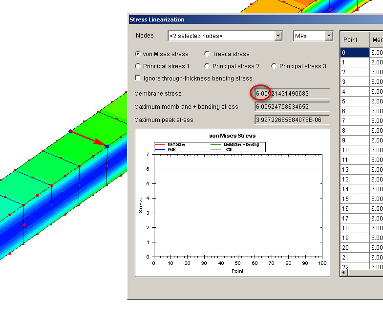

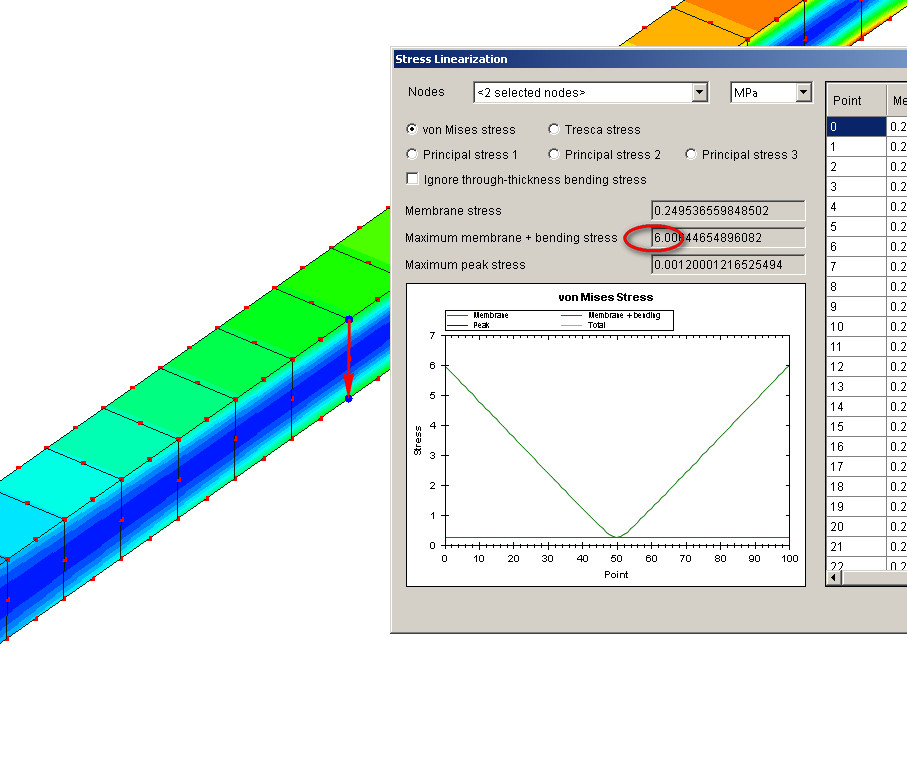

    Example of section of a clamped beam subjected to a pure bending: Upper SCL shows membrane stress equals to maximum bending stress - Transverse SCL shows typical bending stress distribution (absolute values) Max theoretical sigma = 6 MPa
