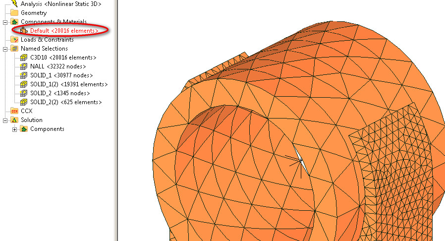

Hi!

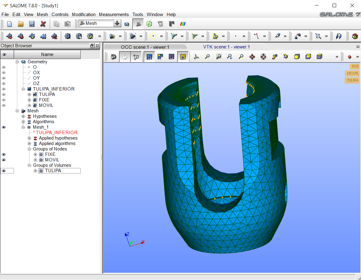

I tried to import (converting from unv to inp) a multibody mesh created on Salome into Mecway.
I tried some ways but in Mecway I have always only one groups of elements under "Components and materials". So I can't apply material for every solid body.
Any idea?
  • If any of the named selections correspond to one part, you can click that to select its elements then add a new component with the selected elements.
    Otherwise, you could use View -> Open cracks to separate the parts so you can select one. To select all the elements through the thickness, select their nodes in Select nodes mode with Show element surfaces turned off then switch to Select elements mode.
  • Create the groups of elements in Salome for each material, then export as .unv and convert to .inp using some command line utility available overthere, I made it everyday and works like a charm,
  • OK! The first way proposed by Victor is quick and it runs!

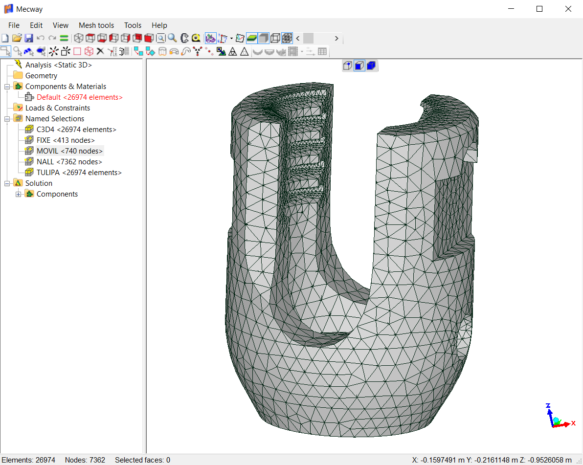

    I think that the problems is *Solid Section card. I don't know how mecway, importing inp, creates parts but maybe depends from this card. If I'm right It involves to apply material properties before importing mesh.
    Thanks, Andrea

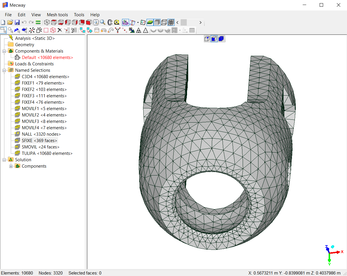

  • I'm using UNICAL as well, but downloaded from some other forgotted place. I'm attaching it if you want to try. I have associated the .unv extension to the unical.cmd (cmd, not exe) file to automaticly convert the files by double clic on the Windows file explorer. Pay attention that the cmd file will create an Abaqus mesh but with .msh extension, you can edit it to create with .inp directly.
    Normally I create groups of elements and nodes in Salome only and works very well (attached one example as well), in fact still I didn't find a way to create groups of faces in Salome.

  • Now guess that understand your problem, you meant Mecway´s components...no, they are not created automaticly, must be recreated using the groups of elements and the contextual menu,

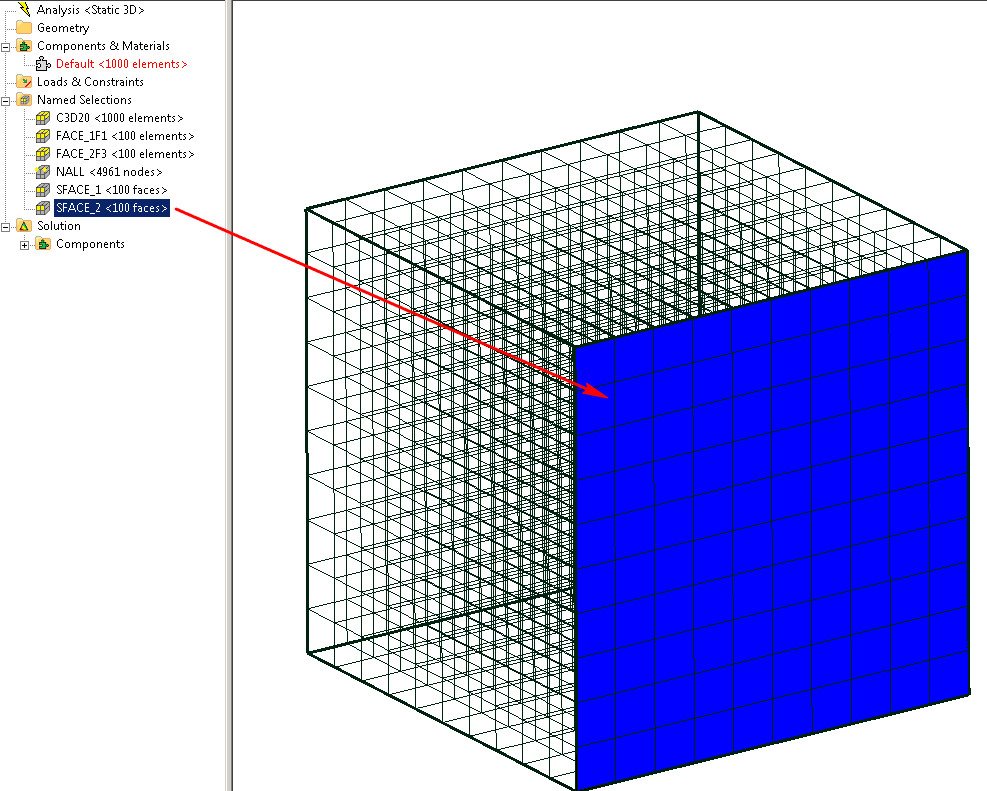

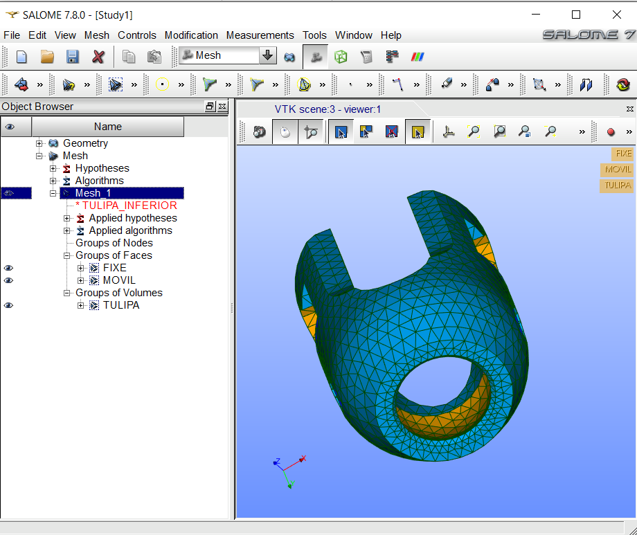

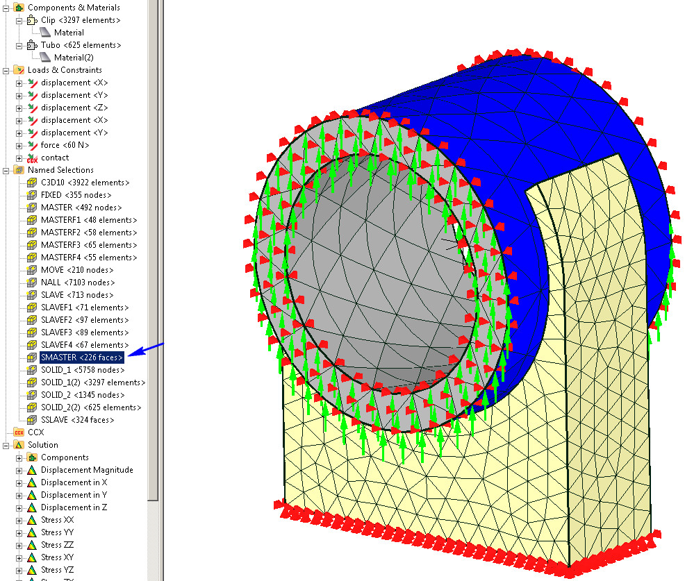

    You wrote that: "still I didn't find a way to create groups of faces in Salome"
    I created them and found them in Mecway. See attached pictures. If you want I can send the procedure that starts from geometry module and involves some steps on mesh module.
    About pictures attached: Mesh created on Salome, imported on MW, created two components but tge groups were automatically imported.

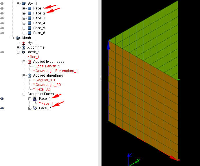

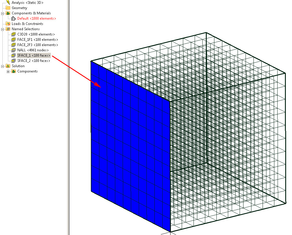

  • On geometry module "Explode" -> select the solid and choose "Face". So you will have all the faces of the solid.
    Mesh module
    Create mesh and compute it - Convert to Quadratic if needed
    Select your mesh (Mesh 1 as default name) on browser on left and choose "Create groups from geometry" ->
    Select "Mesh1" -> type elements _> and on white box the faces that you want (the same faces created under geometry module. These faces are childrens of your solid)
    Export and convert to inp

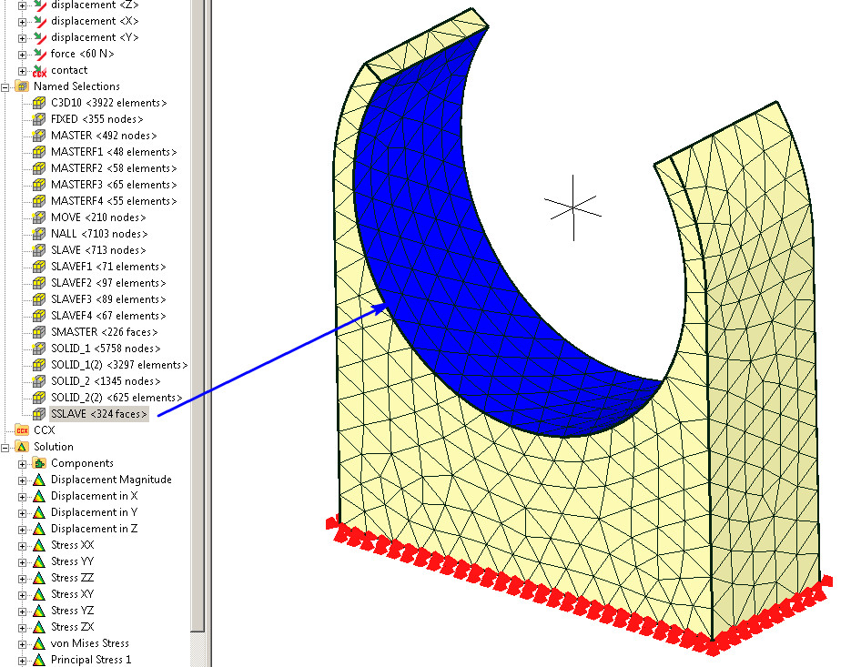

    I attach a simple cube meshed with C3D20 and related file of Mw created importing inp file.
  • Excuse...another pictures for explain better
  • Thanks Andrea, have tested and works. As I say before, the implementation of the tool in Salome is a little confussing, we are using something that says "create a set of ELEMENTS" to create a set of FACES. What is the logic behind that???? I'm sure that they have a reason for doing or call it that way, but to me, is confuse, there is no intuitive way to find the tool.
    Now, one of the drawaback of this method, is that UNICAL create a lot of garbage groups from the Salome sets of faces... I believe that for simple models like that, there is no reason to create the groups in Salome, using the selection tools of Mecway is easier than create in there (because you need to separe the faces in the geometry module and after create the groups based on geometry on the mesh module... to finally clean all the garbage groups in Mecway)

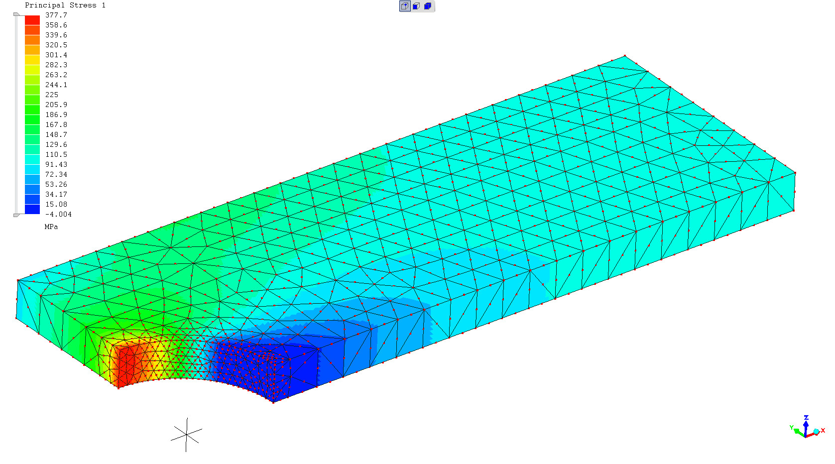

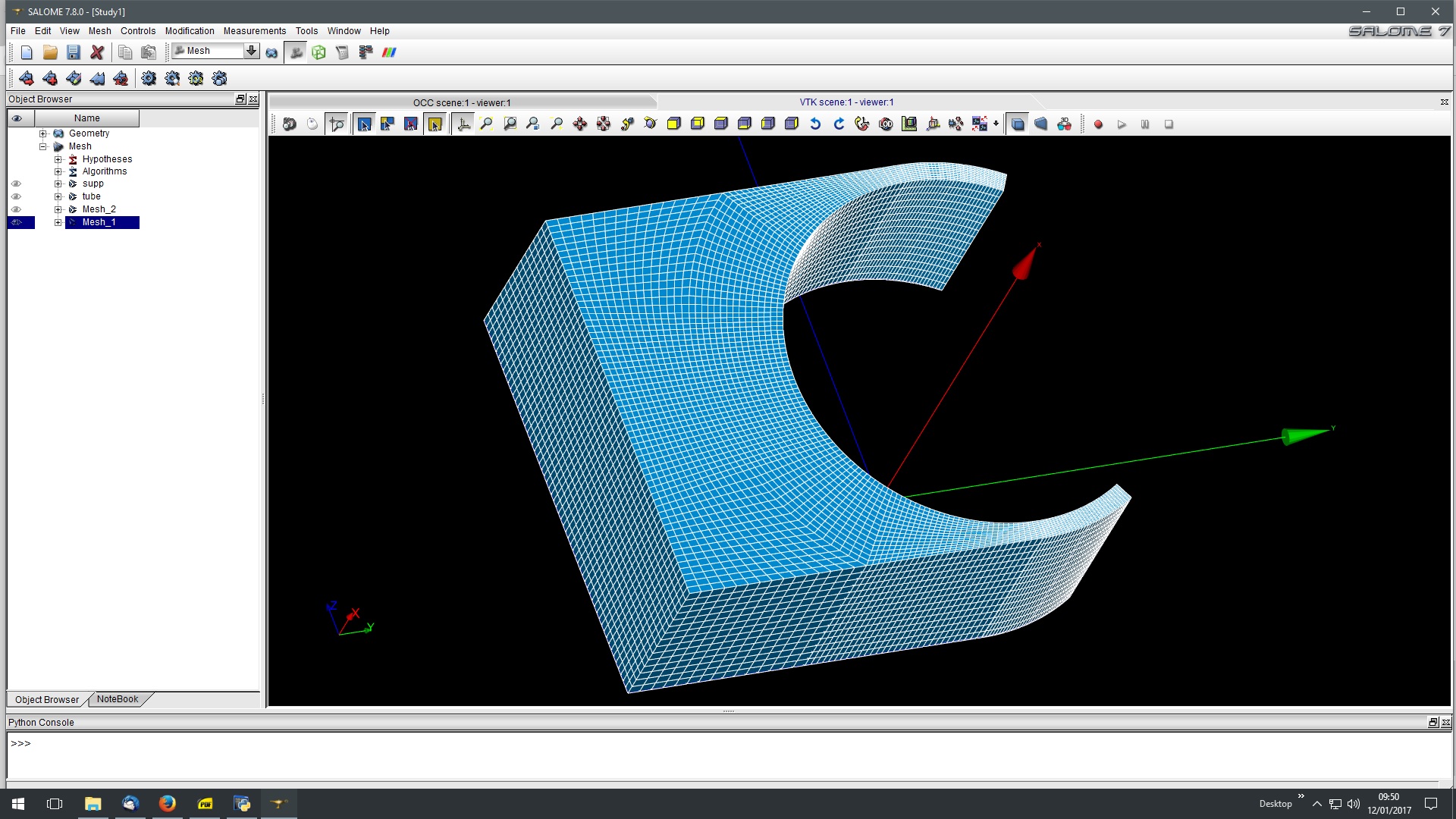

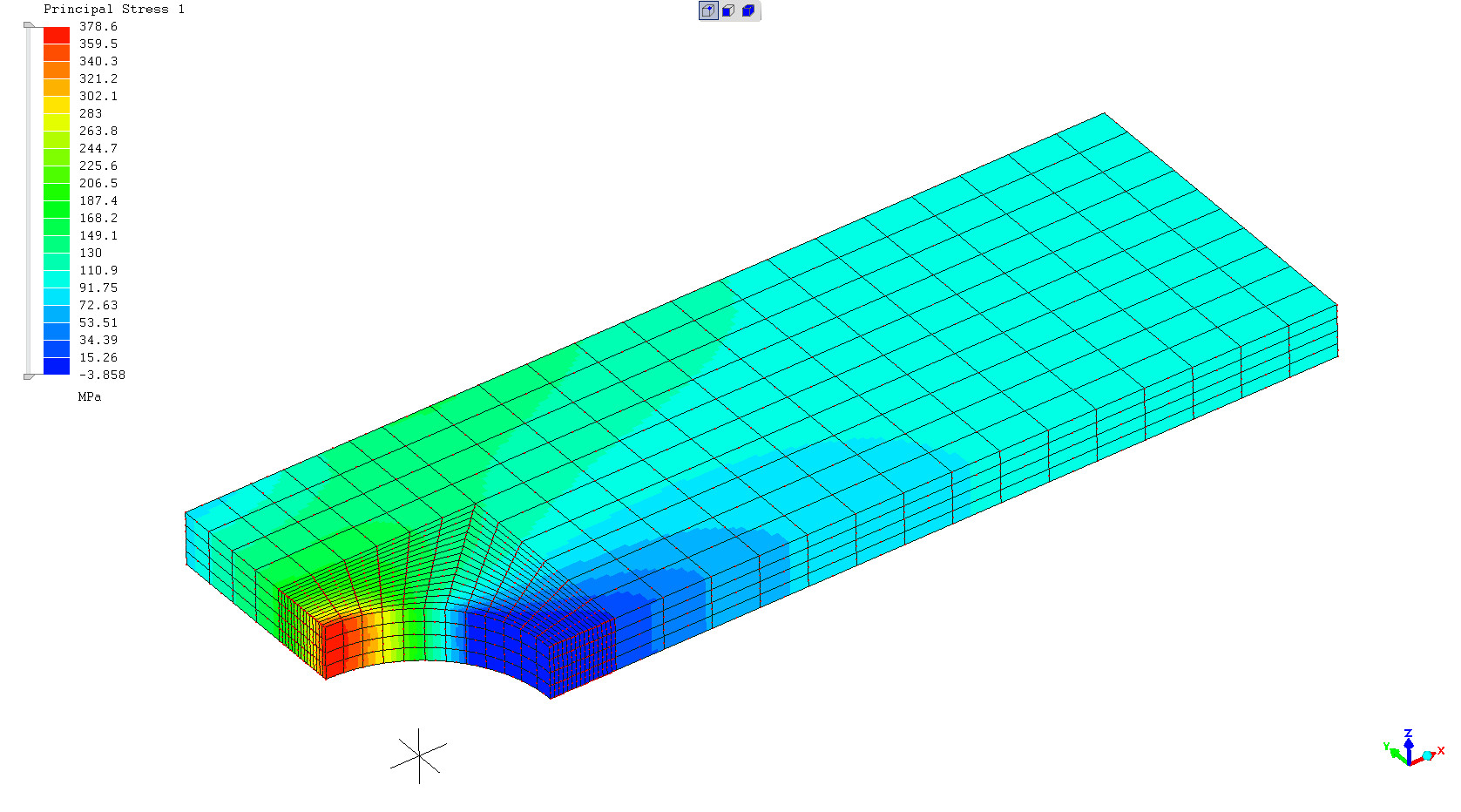

  • I have done my first simple structured mesh in Salome. (All Hexa)
    Applied traction p = 100 MPa
    Theoretical results 373 MPa (eFatigue stress concentration finder based on Peterson's stress concentration factors: W = 25 mm; D = 10 mm)
    Same studies with C3D10 elements

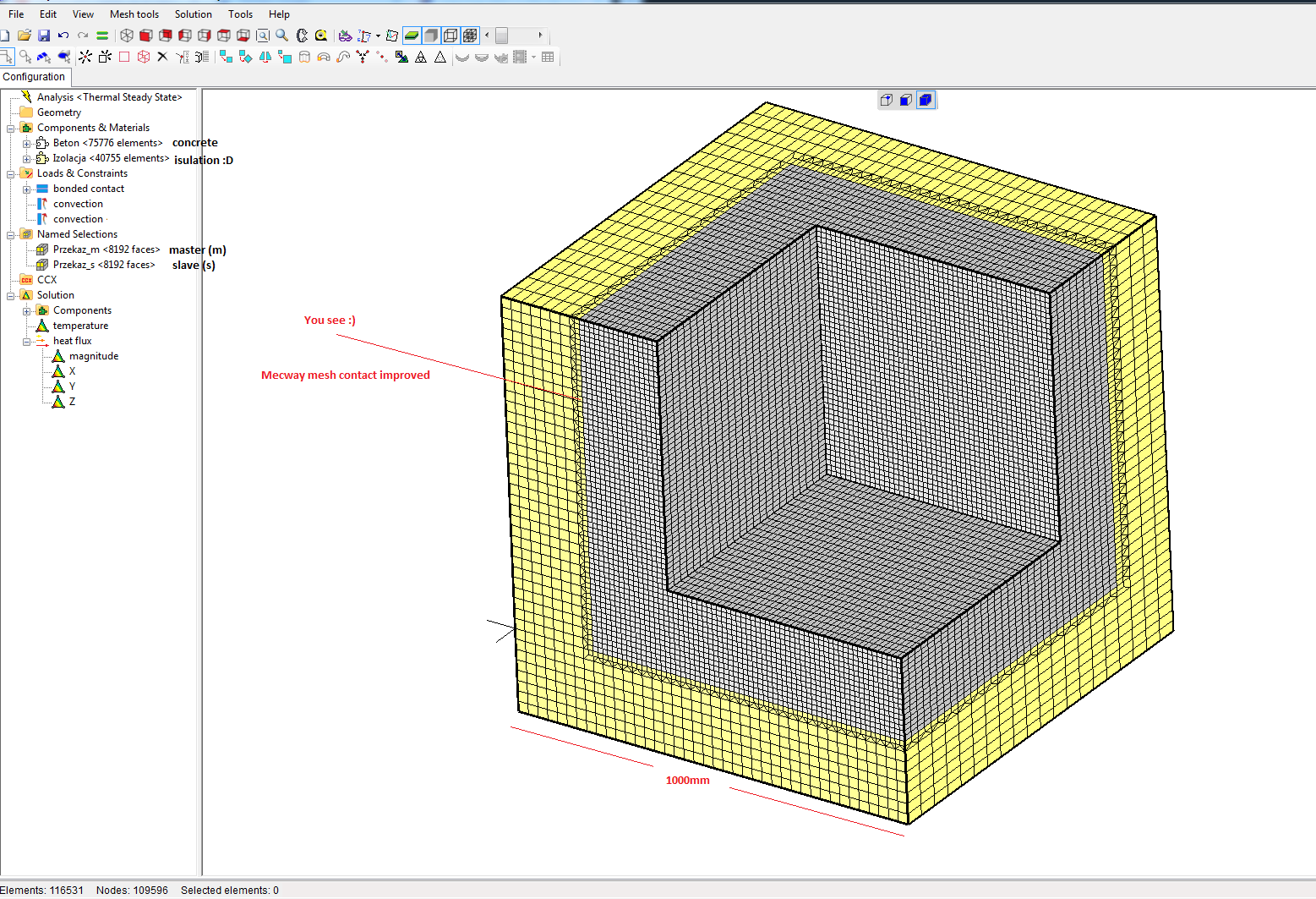

    Hello! Friends
    I have been fighting for the HEX mesh for several weeks, of course, with breaks, no less salome tutorials, how to make one mesh from an assembly, not how to make many separate mesh.
    I look, I search and nothing. Now I wanted to share my discovery
    I will prepare a tutorial in a free moment, now I will describe how and what.
    We insert the sall file into the salome - we give the command "explode"
    we mesh each part of the main mesh (not sub mesh), give command (Mesh / Build compound) selected meshes and it's ready.
    You can export to med file - but Mecaway does not see the separation of solids, although the command (open crak) works and indicates well - that it should be there. We open .med the grid in gmsh - and export(save elelement and save nodes) it as unv. Gmsh sees nicely the sub-grids (though they are meshes, not under meshes: D).
    We open in Macway and enjoy beautifully reticulated assembly. Each part is reticulated separately, you can give different conditions for HEX mesh compaction, and Mecway itself strongly thickens the mesh, and the total "bonduary codntion">
    Really simple steps - now;)
