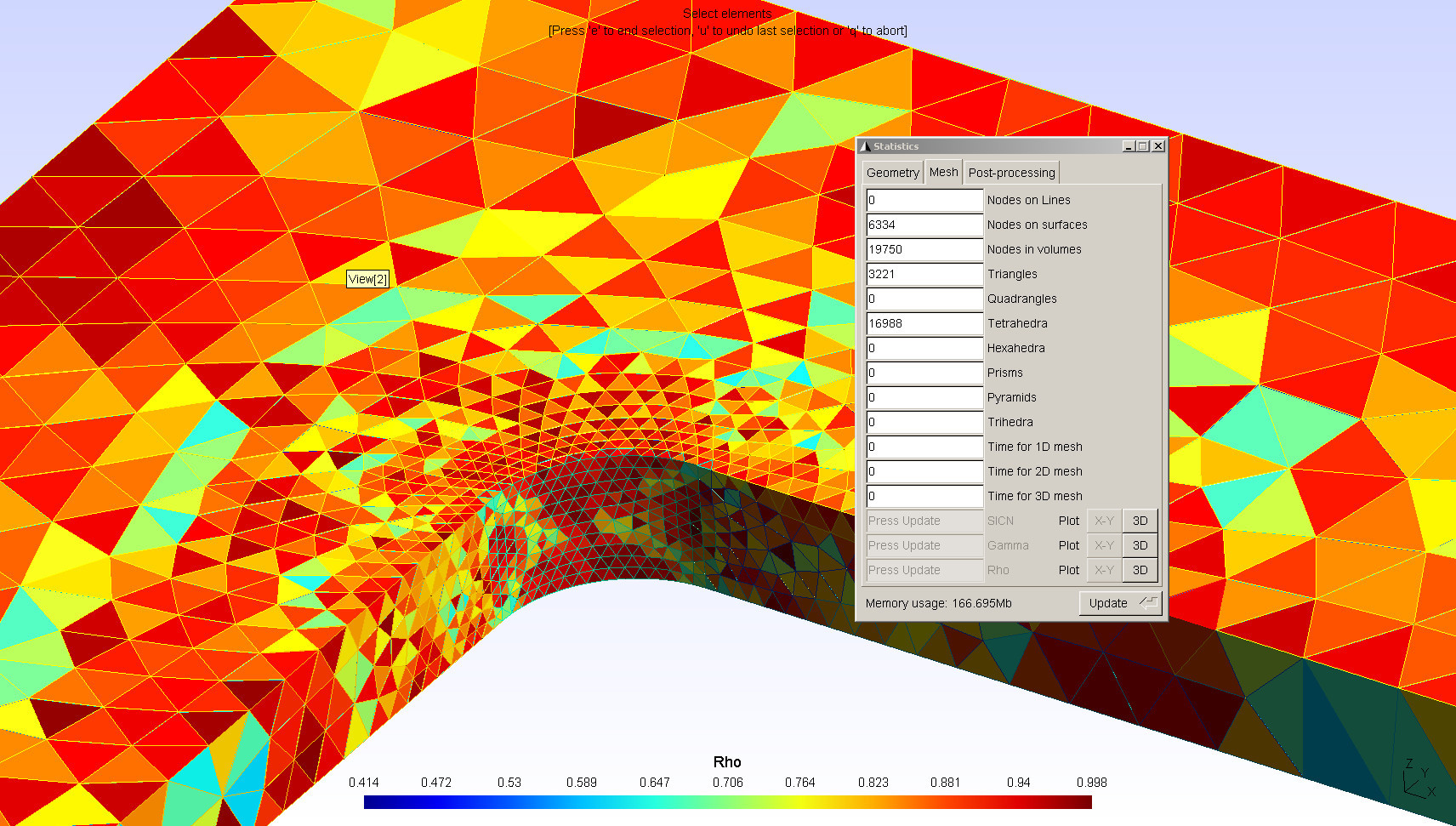

  • To check mesh quality you can download GMSH (freeware).
    On Mecway save as "GMSH ASCII"
    Open GMSH and locate your mesh file. In GMSH go to "Tools" -> "Statistics" and you will find "SICN" "Gamma" "RHO".
    From GMSH documentation
    What is the signification of Rho, Eta and Gamma in Tools->Statistics?
    They measure the quality of the tetrahedra in a mesh:
    Gamma ~ inscribed_radius / circumscribed_radius
    Eta ~ volume^(2/3) / sum_edge_length^2
    Rho ~ min_edge_length / max_edge_length
