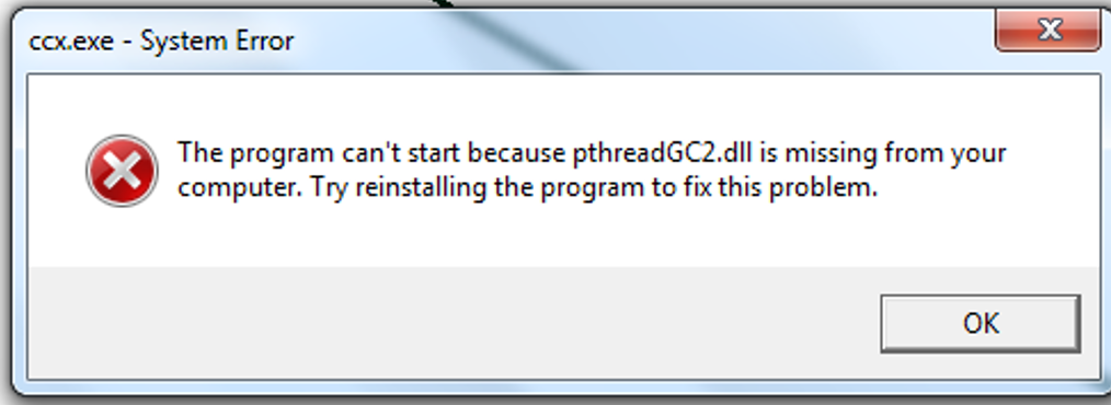

I tried running one of the examples posted to this forum, and received the attached error message.  I reloaded Calculix from Bconverged 3 times, but i keep getting the same error.
I am open to suggestions.

    please check if the library is available. Otherwise try the GE binary (which relies on extanal libraries) or the one I compiled (no external libraries required).
    The missing library should reside in the same folder as the ccx exe-file.
