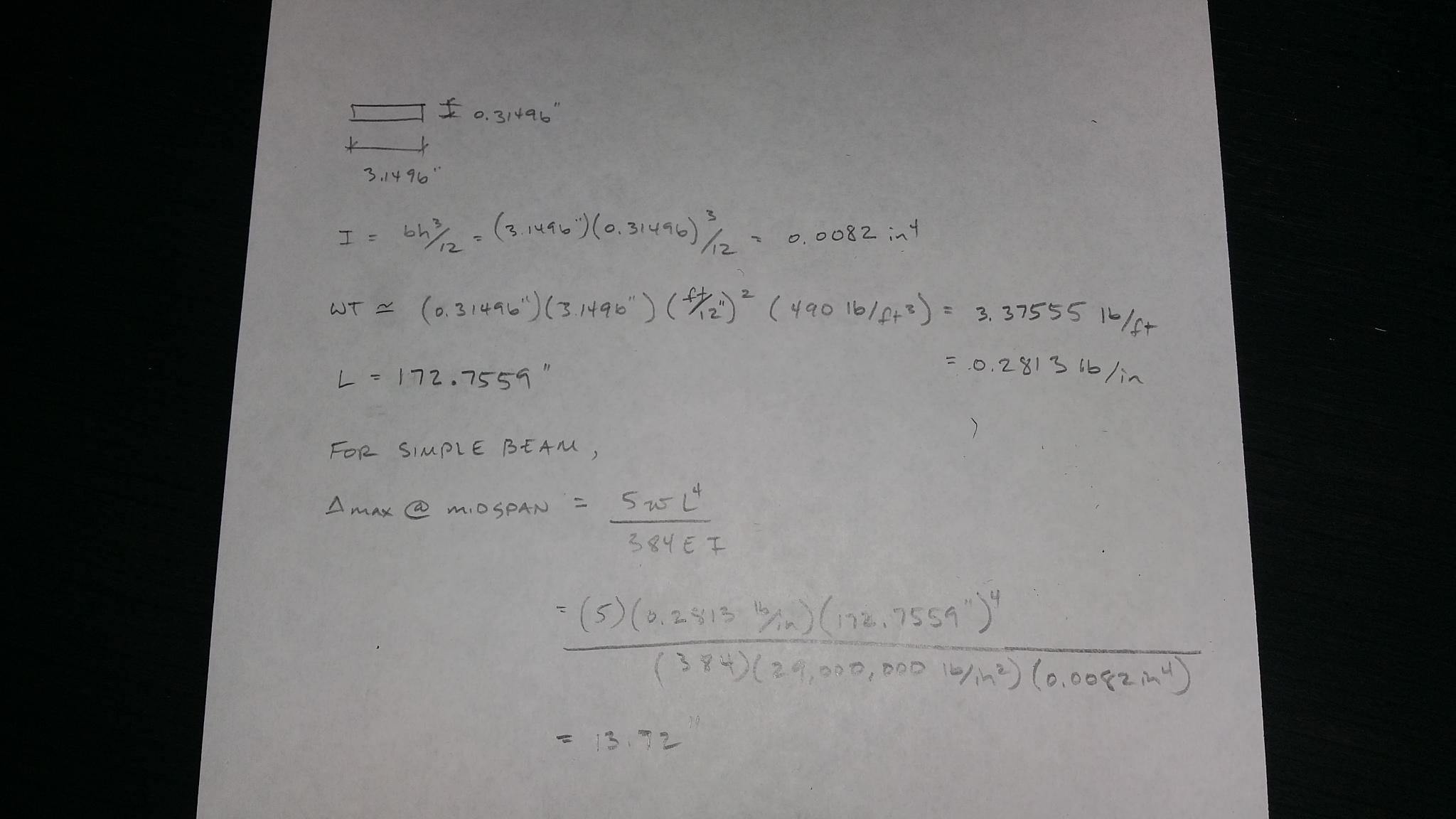

  • Dave, I did a quick hand calculation using the dimension from your model and came up with 13.72" which was close to 340mm.  See attachment.

  • The calculation I did was just checking the analysis results using the same assumptions used the model: linear static analysis. For actual displacement, nonlinear analysis as mentioned by Victor is what I do for this type problem.

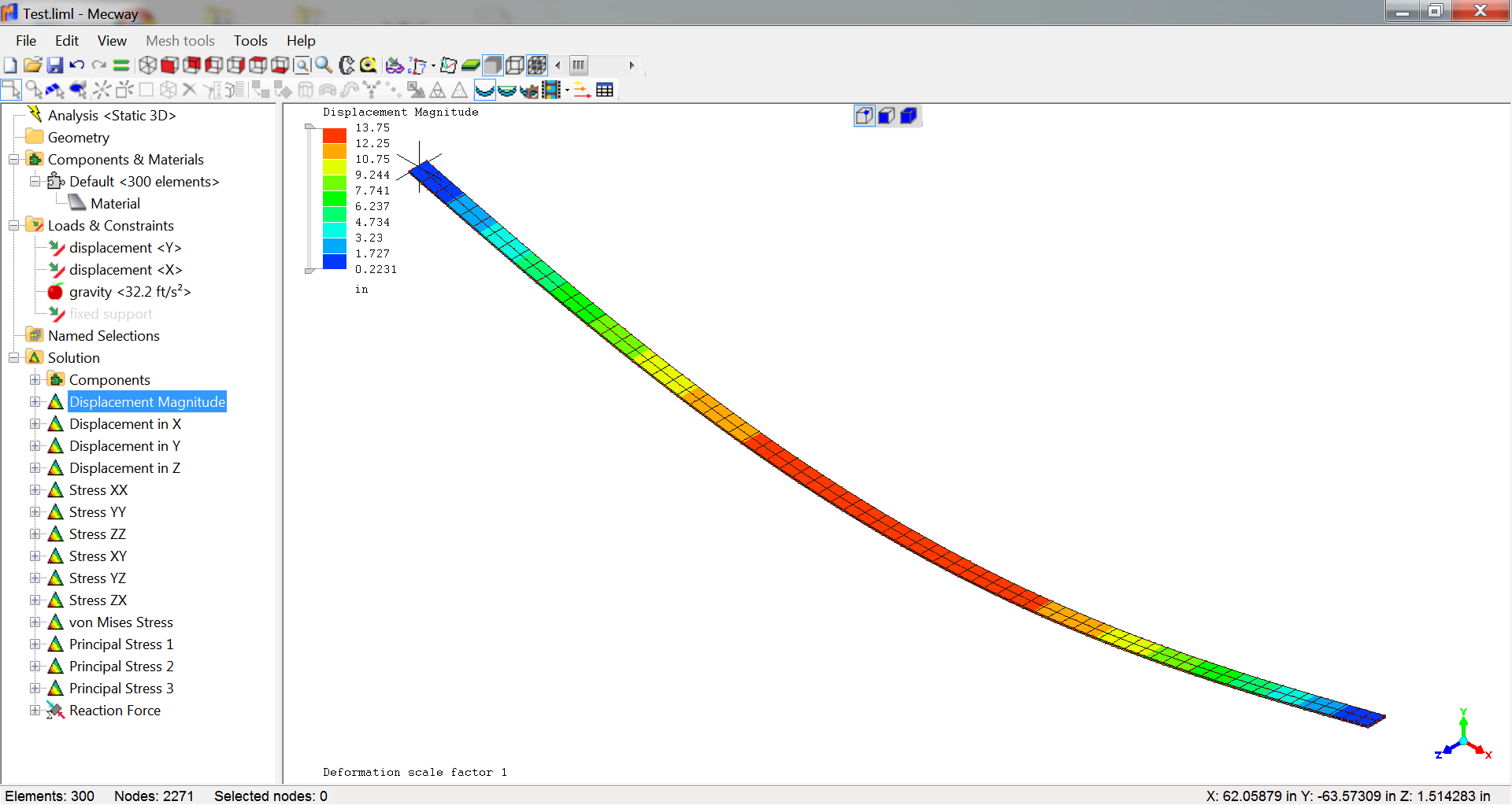

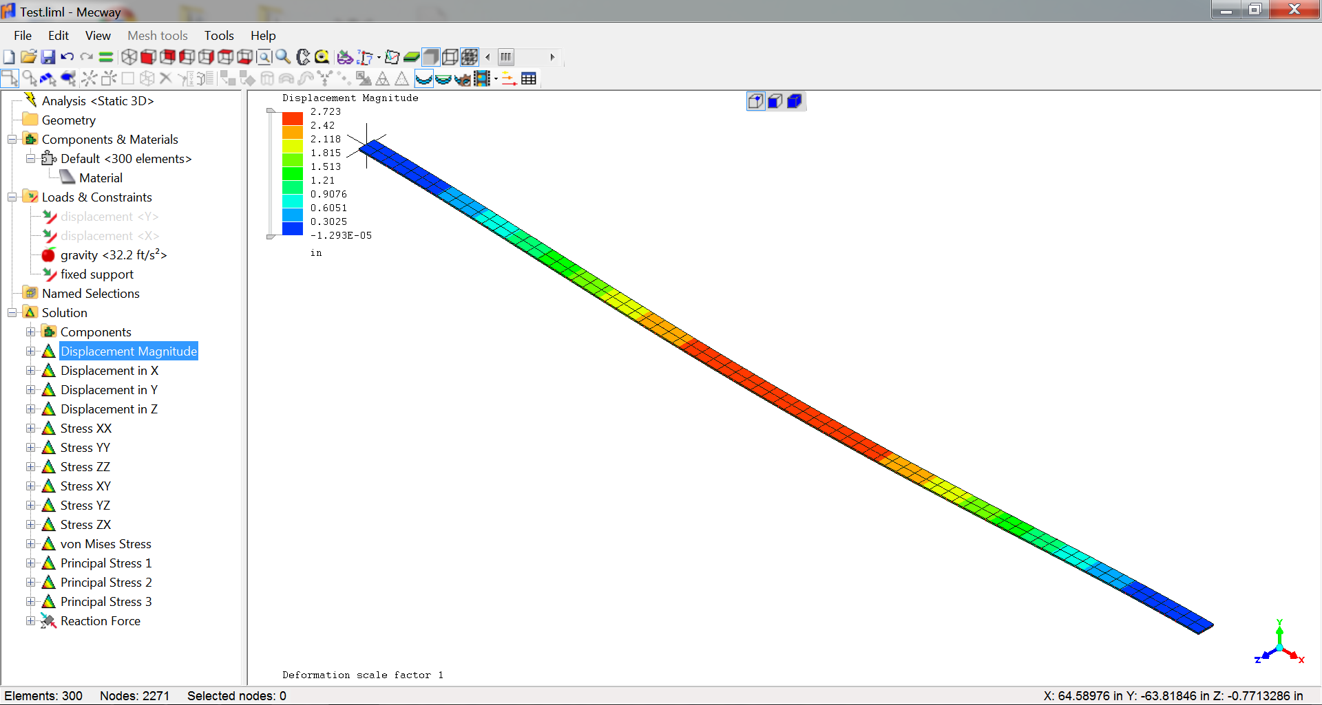

    For linear static analysis, the max. deflection at midspan found to be about 13.75" with the ends simply supported and about 2.72" with the ends fixed.

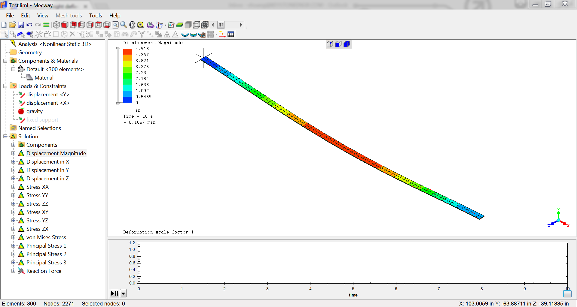

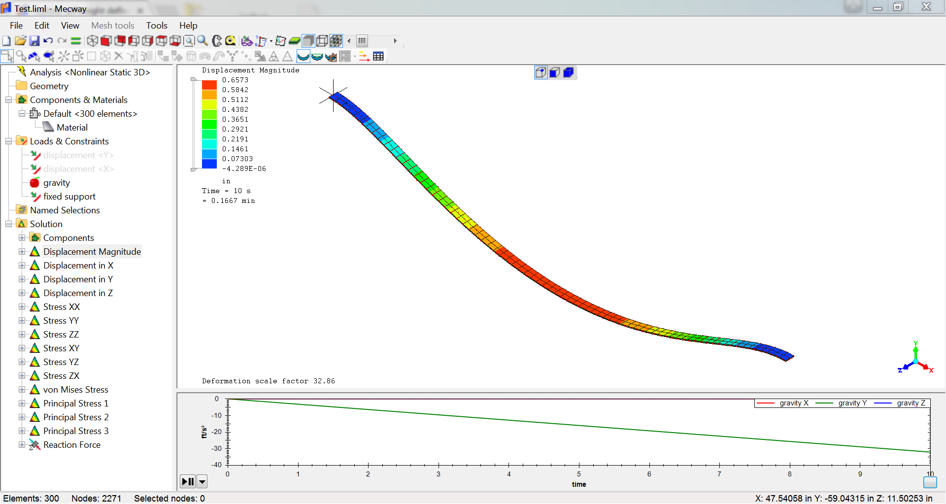

    For nonlinear static analysis, the max. deflection at midspan found to be about 4.91" with the ends simply supported and about 0.66" with the ends fixed.
  • I think that your model for simply supported beam is not correct. In fact end faces must be free to rotate. So Y displacement must be fixed only for bottom nodes and not for all nodes lie on the face. Try to fix Y displacement only for bottom nodes and deflection will be similar to the linear static solution
