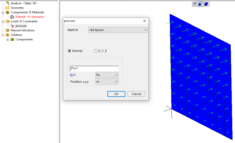

Is it possibile to add "ramp" pressure force to plate (for simulate wind, water pressure or pressure from explosion) - eg. depend on  coordinates?
Is it applied in new version of Mecway ?
  • Yes. You can define normal pressure as a function of (x,y,z,t) in Mecway versions 4,5, and 6 using a formula as shown in this picture, but only with the internal solver and not for CCX.
