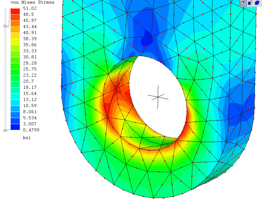

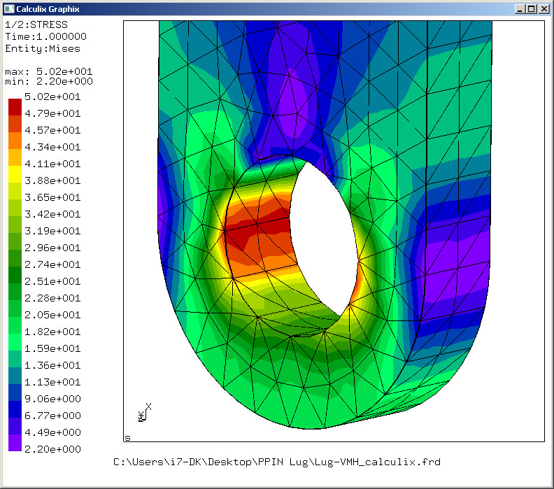

It's only for information. I compared the results from a contact test made by VMH and the results obtained applying to the lug a Gencoz distribution, obviously with the same mesh density.
