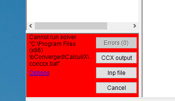

  • That red box error message means the ccx.bat file probably doesn't exist. It may be installed in the \bin folder, not \ccx:
    C:\Program Files (x86)\bConverged\CalculiX\bin\ccx.bat
    I think changing this will get it working.
    Beware that using a .bat file means that if you press the Cancel button or close Mecway while it's solving, the solver may continue running in the background until it's finished. A more long term solution is to globally set the environment variables that the .bat file is setting each time it runs.

  • You shouldn't need to move any files. Just select the .bat file from Tools->Options->CalculiX. Now I guess it's probably starting the .bat file and that may be failing to run CCX but hopefully shows some output. Click the CCX output button after trying to solve and see if it reveals any messages from the .bat file.

  • ...woho! :D
    That did the trick. I just needed to change it from the .exe to .bat file. I returned the .bat file to it location after testing out the different options :)
